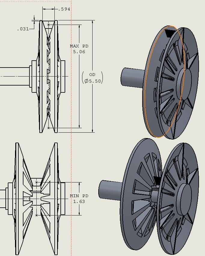

See attached jpg. Based on the geometry shown, low and high output speeds will be:
low speed = 3450 rpm x (1.63/5.06)/1.6 = 695 rpm
high speed = 3450 rpm x (5.06/1.63)/1.6 = 6694 rpm
I haven't verified the 1.6 ratio but assume it is correct.
Effective PD (pitch diameter) is a fuzzy number because it is driven by the cross-sectional shape of the belt, but where I have it is close enough.
Real output rpms should be expected to be +/- 2 percent of these numbers due to deviations from the given geometry, motor rpm, belt wear, belt width and length.
I would set both the high and low speed limits conservatively to avoid the belt getting stuck between sheaves. That is why I have the top of the belt 1/32" under flush with the sheave OD. We would also never want the belt to extend beyond flush.
Why the OP and Dusty cannot get down to 700 rpm (as measured by a meter?) is not clear to me.
- Capture.JPG (95.52 KiB) Viewed 1563 times

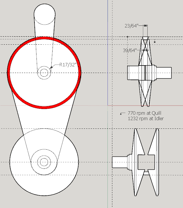

Re: Mark V Speed Control
I just went to the shop to measure. I can not get to 700 rpm. In fact, I don't get close.SteveMaryland wrote: Sat Jul 23, 2022 8:07 pm See attached jpg. Based on the geometry shown, low and high output speeds will be:
With the information you provide in this post I am unable to come to an understanding either. I understand you pulley diameter ratio time motor rpm and I agree that that ratio gets you there. But:
The numbers do not all add up.
With reference to this sketch I am unable to account for about 4" of the motor belt and the only place the difference can be introduced is in the circumference of the idler pulley.
The belt is 27" long. The pullet axis are separated by 7.25" thus accounting for 14.5" of the 27".
The idler pulley is at maximum diameter thus accounting for 15.895" while the motor pulley (by calculation) accounts for 5.1208", Total belt length accounted for is 23.087"
Where is the rest of that belt (4").
I contend that it resides on the idler pulley (by necessity) making the stated sheave ratio incorrect. Represented by the red ring.
Please correct where ever I am wrong.

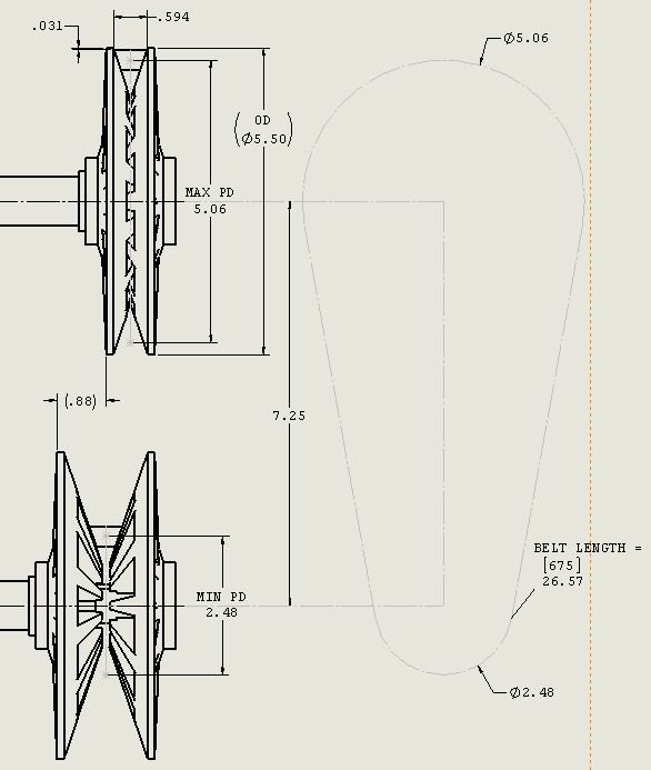

- SteveMaryland
- Posts: 227
- Joined: Sat Nov 06, 2021 3:41 pm
- Location: Baltimore, Maryland
See attached jpg.
Previously I did not consider belt length - but I should have because it matters here.
The "official" Shopsmith drive belt length says 675 mm which is 26.57" - which is not 25.42". But not 27" either.
BUT if the previous 1.63" PD were changed to 2.48", belt length would change to 26.57 = 675mm. And thus with the "official" Shopsmith belt:
low speed = 3450 x (2.48/5.06) / 1.6 = 1057
high speed= 3450 x (5.06/2.48) / 1.6 = 4399
So now I also don't see how 700 can be obtained if the "official" belt length is used. A shorter belt would do it.
Shorter belt = lower min speed, higher max speed.
Longer belt = higher min speed, lower max speed.
- Capture3.JPG (38.59 KiB) Viewed 1428 times
I think this may be one error in your model. The belt length needed to travel between the two axes is not constant. The belt is vertical, or perpendicular to the axes, at only one speed. Therefore the 14.5" is only correct at one speed. At all other speeds it is at an angle to vertical and the length will be increased.dusty wrote: Sun Jul 24, 2022 12:40 pm ...
The belt also does not maintain 180 degrees of contact on the sheaves. A small error will be introduced if you are assuming it does so.
