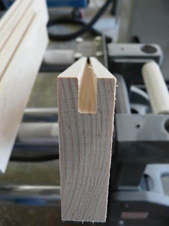

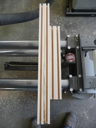

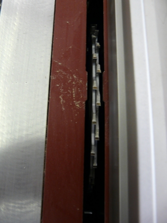

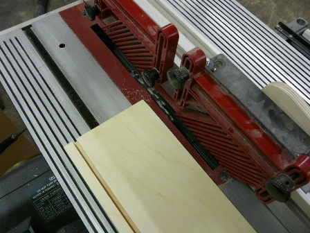

The door style for these cabinets starts with a simple shaker flat panel. To that we will add a molding around the inside of the panel. This post is about setting up the Shopsmiths to run the rails and styles. I set up the 520 to run a 1/4 inch groove 1/2 of an inch deep. Both rails and styles get this cut. We will then cut the rails on the Mark 5.

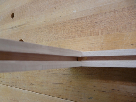

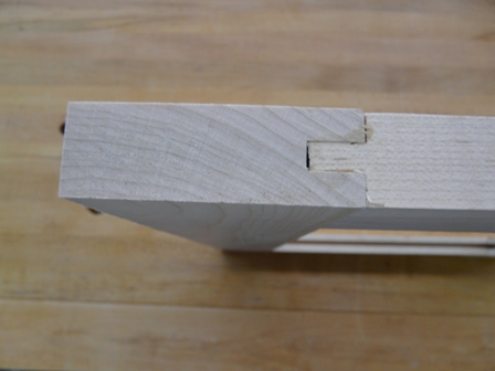

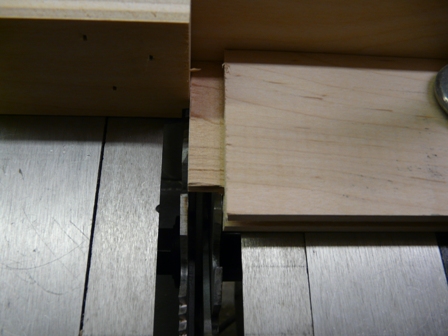

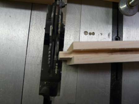

To cut the rail ends I use a simple jig on the miter gage. Set to notch the ends at just under 1/2 of an inch.
[ATTACH]4213[/ATTACH]
[ATTACH]4214[/ATTACH]

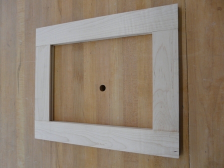

I made this sample door without the panel for demonstration purposes.
[ATTACH]4215[/ATTACH]
[ATTACH]4216[/ATTACH]
[ATTACH]4217[/ATTACH]
Mark

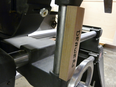

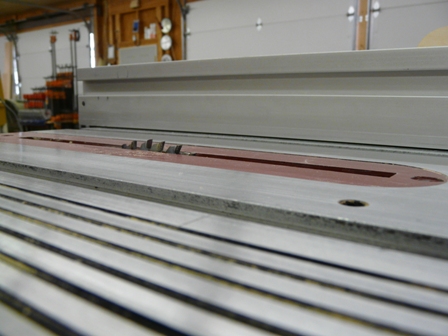

Some of you may have figured this trick out, great minds thinking alike and all. :) I use my 520 for several different dado operations. I discovered that if I cut a memory block for each operation it saves a lot of trial cuts when I need to set one up. This is for dadoing the drawer sides for bottoms.

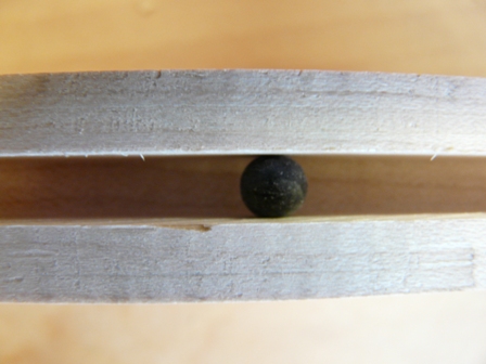

I like to use space balls in the panels of the doors. Cut the door panel 1/4 inch smaller than the space. This allows 1/8 inch all the way around the panel. I use 8 space balls per door.

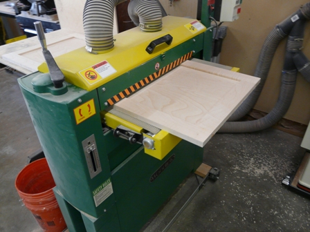

The drum sander makes short work of sanding. I sand down to 120 grit here and then back to the orbital sanders 120 for paint grade 120 and 150 for stain grade. Be sure you get all the cross grain sanding marks out.

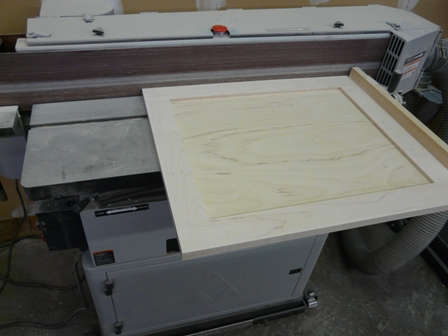

I make inset doors the size of the opening and then cut them down to allow 1/16 inch all the way around. Here I am sanding on a edge stroke sander. The Shopsmith with the sanding fence and drum sander would do a good job on this operation.
