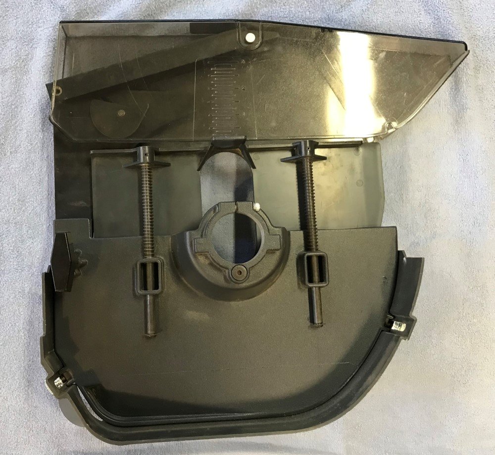

The Upper and Lower Saw Guard assemblies are currently listed available here on the website. The Upper Saw Guard assembly is part number or SKU: 514366 Price $99.95 and the Lower Saw Guard assembly is part number or SKU: 514358 Price $179.95. This is the Saw Guard Assembly pair (shown below) for all Mark V models except the Mark V 500 with the original Table System. It is also for the current Mark 7 (not the 1960's Mark VII) and the Mark 4.
Shopsmith USA currently has a policy of only accepting orders for items in stock.

Thanks Russ. That's the lower guard I ordered. Which looks exactly like the used lower guard I got off Ebay :mad: :eek: . It took 73 years for me to realize I'm an idiot!!I couldn't get the Ebay guard to lower completely over the blade so I figured it was wrong. $252.00 (exchange rate CDN$ to US$)later I figured out that the Ebay guard and the new SS guard wouldn't lower because I had (I don't know why) taken the stop collar off the quill. :( :confused:
After re-installing the collar everything works fine. So I have an extra saw guard if anyone is looking (and an ER10 but thats another story)
