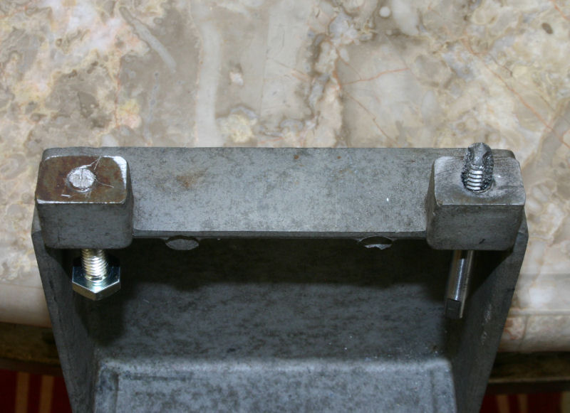

mickyd wrote:
I'm sure you guys have seen enough snapped screws / bolts in your days but since this post has absolutely NO PICS yet, here's what I'm facing. The views are looking down the length of the extension table.
front (inside)
[ATTACH]6797[/ATTACH]

The thrill of victory
The thrill of victory is sweet!! I managed to maintain an original threaded hole on the extension table vs having to do a JB Weld repair job.
The first step was to try and correct the offset error that I made when I drilled the original pilot hole. I was able to do that by carefully reaming the hole concentric to the original threaded hole using a dremel tool with a high speed cutter. This cutter is like a square face end mill since it cuts both on the side and end.
[ATTACH]6827[/ATTACH]
I worked on the hole on the right side of the photo below. The hole on the left with the bolt shown in the backside still has the snapped screw. The bolt on the backside is there as a stop reminder to protect the vigin thread once I start drilling.
Once I got the right hole concentric, the next step was to drill a thru hole one size smaller than the one recommended for the tap size. I went one size smaller since there were already threads there, although they were covered with the left overs of the fastener material and not fully visible. I started the tap from the backside where the virgin thread was. This helped maintain the original thread position. This was a little slow since I had to turn the tap with an adjustable wrench 1/4 turn at a time. It took a while but it was very controlled.
[ATTACH]6830[/ATTACH]
End result is I hit the original thread. I guess this would be considered "chasing" the thread as jpg mentioned.
[ATTACH]6828[/ATTACH]

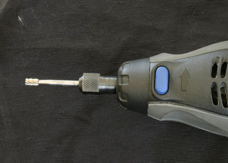

Only 3 more to go, one more on the extension table, and 2 more on the work table. To make sure I hit the center of the fastener this time, I am using the right angle method to "find the center of a circle" from this post. You can see the scribe lines on the left screw already. I hit it with a center punch already and it looks like it's dead on. I used a corner of metal scale as the right angle then I scribed the lines with a razor blade.
Off to do the others.
