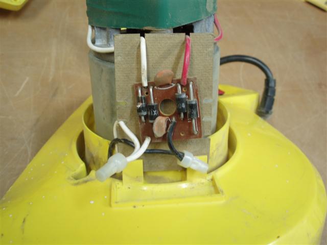

I've been put on restriction and I'm about to go stir crazy. To prevent that I've been searching out some of the 'small tasks' that require no lifting to keep my mind off this agonizing wait til surgery tomorrow.
Aaaah, the leaf blower. That's not heavy. Once I get it down on the bench SWMBO should have no problem.
I use the leaf blower when I clean the shop out (spring and fall cleaning). No leaves here so it doesn't get used otherwise.
It runs but it sorta pulsates rather than run at a constant speed. A visual inspection reveals a couple of broken parts on a circuit board attached to the side of the motor. There are part numbers (I think) but they don't seem to cross. The number appears to be PX1N404. Thought I'd find that online or at the Radio Shack but no luck. Radio Shack used to be the place to go for electronic parts but that doesn't seem to be the case anymore. They are very specialized and no longer stock a wide variety of small parts.
Went looking for Allied Radio but that doesn't exist - at least here in Tucson.
Oh well, I didn't really want to fix this today anyhow. I just thought I did.
[ATTACH]8001[/ATTACH]
The little black component on the left side of the circuit board is broken.

Circuit boards on a leaf blower!!!! What's the world coming to? I can't stand electronic boards in my yard equipment. I don't want them. I don't want electronics controlling my accelerator and braking system in my car either!! Hey, call me old fashion!!dusty wrote:I've been put on restriction and I'm about to go stir crazy. To prevent ......
It runs but it sorta pulsates rather than run at a constant speed. A visual inspection reveals a couple of broken parts on a circuit board .....

Hey, Mickyd, this is not a new leaf blower. I would guess it is fifteen years or more old. Rectifier diode technology has been with us a while. I just hate to discard anything that can be fixed.mickyd wrote:Circuit boards on a leaf blower!!!! What's the world coming to? I can't stand electronic boards in my yard equipment. I don't want them. I don't want electronics controlling my accelerator and braking system in my car either!! Hey, call me old fashion!!

Thanks for straightening me out. Like you, I always try to fix stuff, then I throw it away.dusty wrote:Hey, Mickyd, this is not a new leaf blower. I would guess it is fifteen years or more old. Rectifier diode technology has been with us a while. I just hate to discard anything that can be fixed.

I do that a lot, too. Throw it away after I have tried to fix it. But not this one. At least not yet. I found two finda similar diodes in the scrounge box and they fix the rectifier problem. Then I took a baling wire lesson, using nylon lacing tape and secured the brush holders in against the armature and it now runs at a constant speed.mickyd wrote:Thanks for straightening me out. Like you, I always try to fix stuff, then I throw it away.
How long - that's another thread for later. A lot later, I hope.
