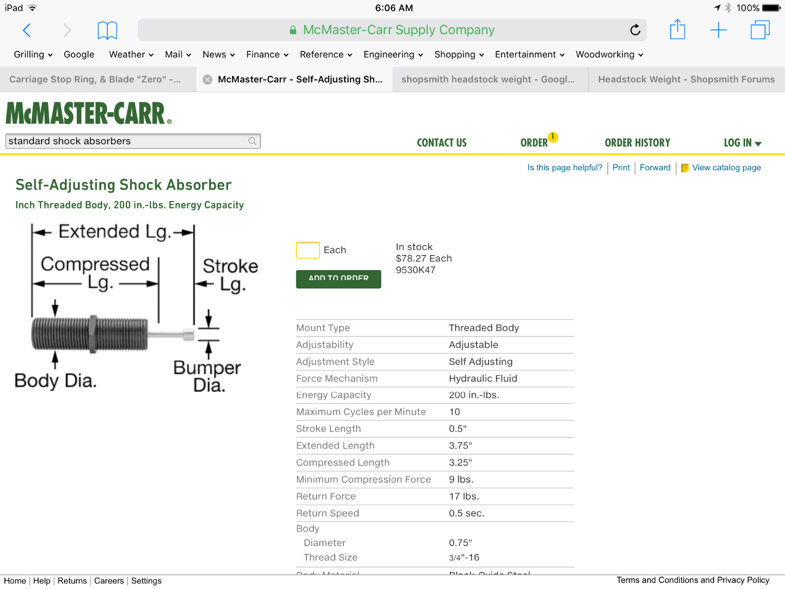

If you're serious about preventing damage when something as heavy as a headstock slide-hammers a structure, you need something like the hydraulic shock absorber below.
I've used them as part of an upgrade package for cam-operated machine tools, with spring-return tool slides. If a slide sticks while the cam retracts, and then lets loose, you have a heavy return spring accelerating a roughly 100-lb tool slide at about 1 g. When it impacts, it bends or breaks OEM parts. But with one of these shock absorbers installed, all that kinetic energy is harmlessly turned into heat in the shock absorber. It doesn't even make a thud.
The energy-absorption requirement for a Shopsmith is roughly 50 lb. x 3 ft, or 150 ft-lb. The shock absorber below has a stroke of 1/2", and thus it must apply a stopping force of at least 200 / (0.5 /12) = 4800 lb to absorb that much energy. So you'd better have a sturdy mount for it. This also illustrates why something with limited compressibility, such the standard SS stop rings, will generate an even larger impact force.
EDIT: Whoops, I just notifed that the shock absorber shown above is rated for 200 inch-pounds, not 200 foot-pounds. So a considerably larger one is needed, at about 3x the cost. I thought that one was mighty inexpensive.
