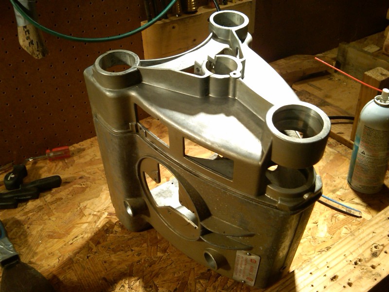

Here's a shot of the headstock casting after some mineral spirits, tooth brush and a soft paint remover wheel.
[ATTACH]10892[/ATTACH]
Cleaned Up Headstock Casting.jpg (131.12 KiB) Viewed 6109 times

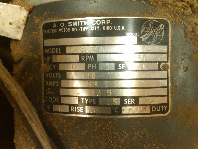

You won't find much info, because it's a proprietary motor.
Remove the sheave by loosening the set screw, it should just slide off then. Well except it might be gunked up. Oh and NEVER let go of the the outside sheave, when ya have it pulled away from the other one.

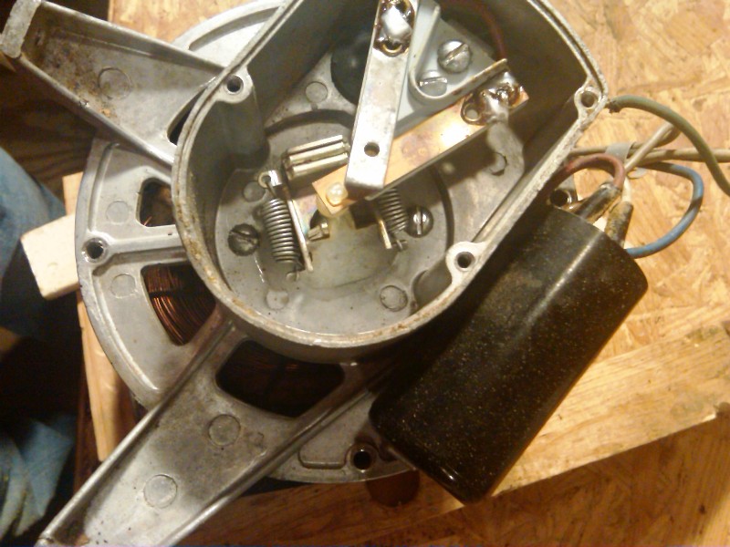

Here's some pics for my 1 1/8 hp A.O. Smith Motor. I still haven't figured out how to get the dad burn thing apart. I'm thinking I'm tackling it from the wrong end.
[ATTACH]10899[/ATTACH]
[ATTACH]10900[/ATTACH]
This photo is after I blew it out and removed the back cover.
[ATTACH]10901[/ATTACH]

On the long shaft end look up from the bottom through the fan opening. There be set screw that you see as you turn the shaft. After you loosen the set screw and remove the 4 long screws on the capacitor that end that is holding both ends of the motor. Sorry you already have the long screws out. With the set screw loose pull the shaft end cap of the motor (fan housing)off.
