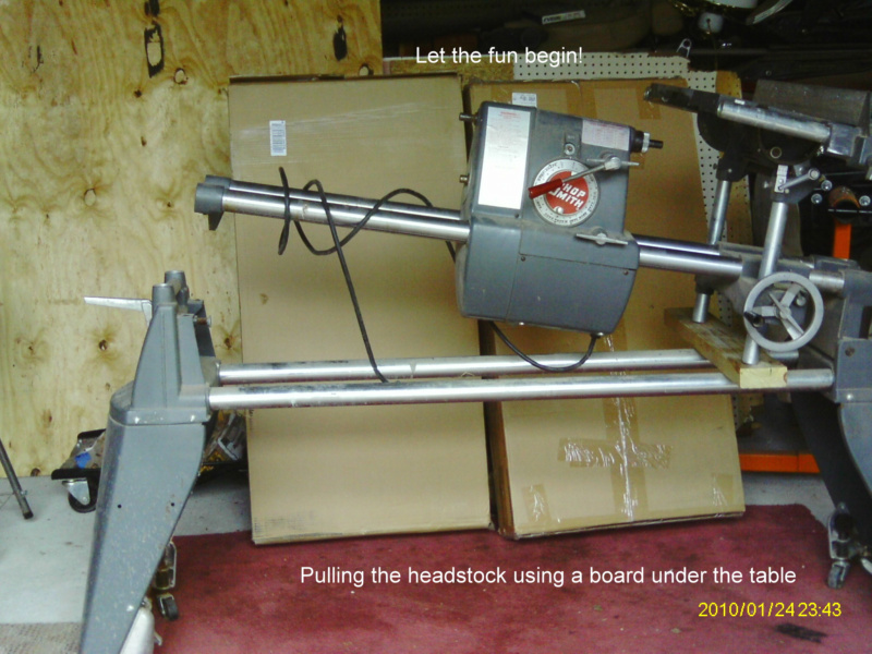

Last night I finally started getting into this unit to address whatever problems it might have. It turned out to be a good evening.
Removing the headstock: the tubes are a bit rough but the tiebar came away easily enough and the headstock slid off with a bit of effort.
[ATTACH]12364[/ATTACH]

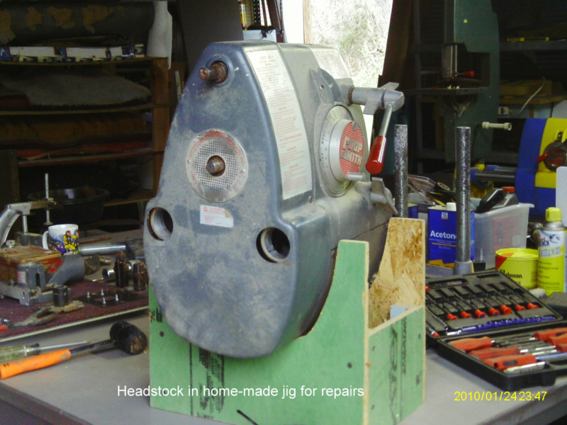

Here's the headstock in a "Sawdust Session" inspired jig to hold it for repairs/maintenance.
[ATTACH]12365[/ATTACH]

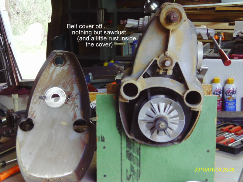

First off, the belt cover. As you can see, just some sawdust inside and the expected rusting from condensate inside the cover.
[ATTACH]12366[/ATTACH]

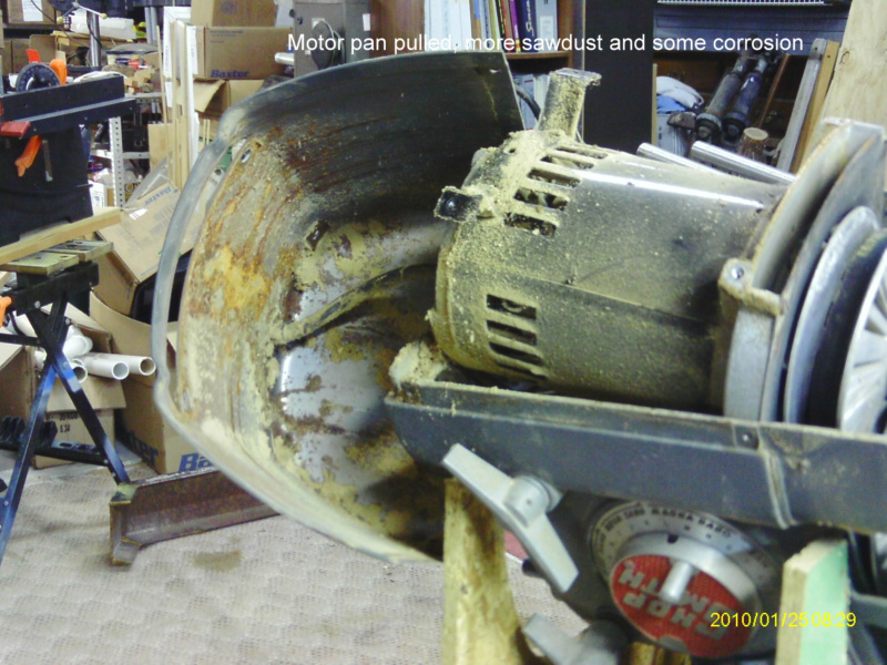

And next, the motor pan. Same story.
[ATTACH]12367[/ATTACH]

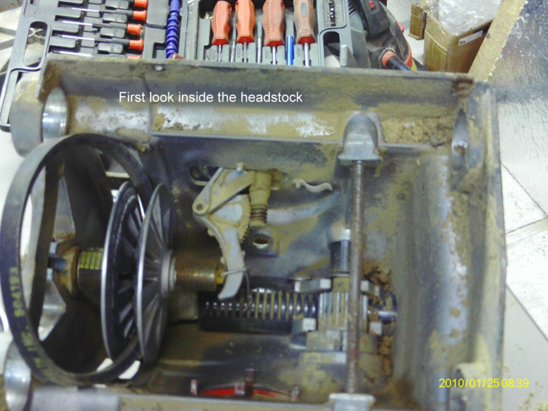

And now we can finally get our first look inside the headstock.
[ATTACH]12368[/ATTACH]
Not any real crud anywhere, just some compacted sawdust. Time to get out the small brushes and fire up the air compressor......

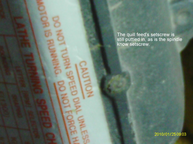

From everything I saw last night as I began cleaning the headstock, I'm fairly certain this unit has never been opened up. It still has the putty in the quill setscrew and the spindle knob setscrew:
[ATTACH]12371[/ATTACH]
Also, the motor pan bolts were really difficult to break loose and remove. I ended up using a Phillips bit that fit tight with a crescent wrench and trying to turn as I tapped it with a rubber mallet. Inside everything was there, including the paper dust shield on the switch.
And I think it is fairly low hours. As I was cleaning inside I thought I could see some wear on the teeth on the pork chop assembly. Turned out to just be a little impacted sawdust that I got out with a pick.
Everything seems to turn smoothly and do whatever it is supposed to do without any roughness or difficulty. The quill feed teeth weren't even very dirty.
Bottom line, I'm going to oil, lube, wax, etc. all the things that need it, put things back together, go thru a thorough alignment process and start making sawdust. At this point, priming the inside of the belt cover and motor pan, and cleaning up the tubes are the biggest obstacles to being up and running. Well, that and cleaning up the miter bar which is REALLY rusted.
