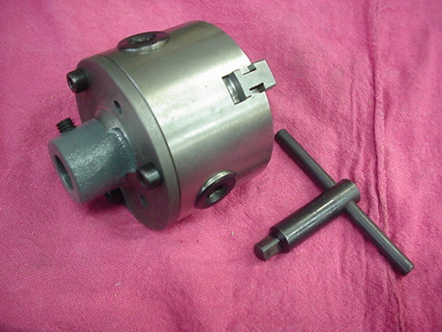

If you want to hold rectangular stock in a chuck, you'll need an "independent" four-jaw chuck. The Grizzly H8047 (mentioned yesterday in -- http://www.shopsmith.net/forums/showpos ... ostcount=2 -- ) is an independent four jaw, but I don't know if it can be secured to the Shopsmith spindle. Then there is the Grizzly H8049, also mentioned yesterday, which you could mount to the Shopsmith via the Penn State Industries 1" x 8 TPI to 5/8" smooth bore adapter.

Over on the yahoo 10ER group, Skip Campbell mounted a small metal working chuck onto a cast iron Shopsmith faceplate using a metal lathe to get the chuck centered and aligned with the faceplate -- http://mkctools.com/mvc-136c.jpg
