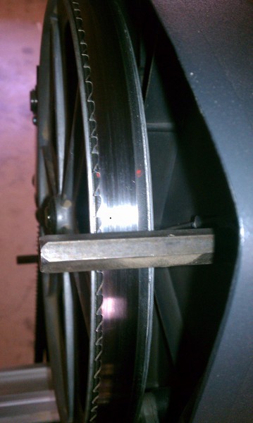

In the picture it is not quite a 25 degrees but this is the only picture I have of
this until I get home from work.
I lay the allen across the blade so the angle could be seen.
[ATTACH]20589[/ATTACH]
for example.

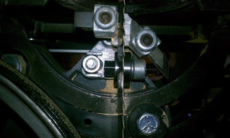

Any chance you can post a few pics? I can't imagine how the blade could be skewing like that if the guide blocks are properly oriented or not touching the blade at all. Oops, I see you have the upper guide photo. How about a pic of the lower guide? Also a pic inside the cover showing where the blade is riding on the wheels....

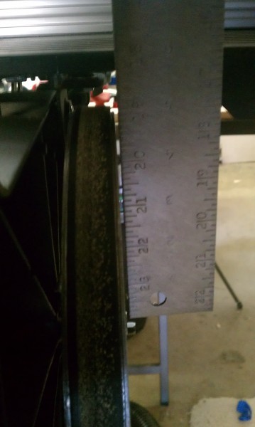

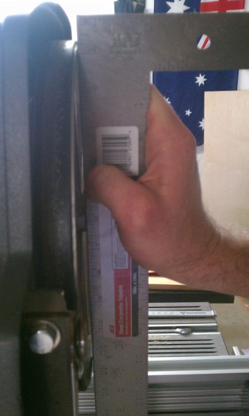

Here are some more pics,
I put the original single bearing back in for these pics
This is the Upper wheel so you can see where the blade sits
[ATTACH]20593[/ATTACH]
The next is the lower wheel
[ATTACH]20594[/ATTACH]
I am assuming this is what you meant?
[ATTACH]20596[/ATTACH]
Distance from lower wheel
I think it measure at 1/16
[ATTACH]20597[/ATTACH]
lower blade guide
[ATTACH]20598[/ATTACH]
lower blade guide

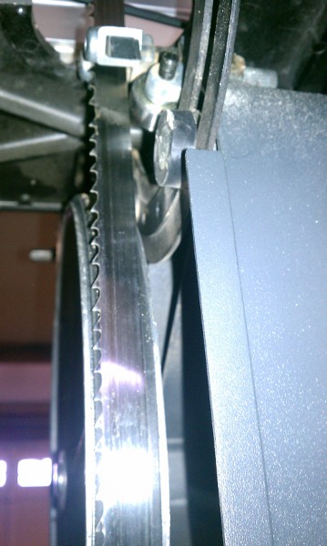

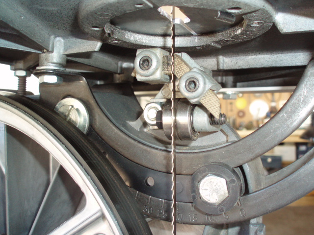

After looking at the picture of the lower blade guide the only thing stopping the blade twisting more is the fact that it hits the cool block mount.

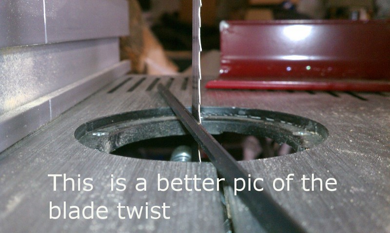

here is a clearer picture of the blade twist
[ATTACH]20599[/ATTACH]
This was not easy for me to describe. How would you guys have done it?
Caleb
Caleb

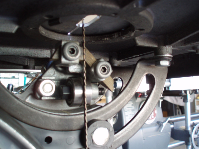

- Posts: 21481
The twist is definitely not right and in the next to last picture, it appears that the blade does not run between the cool blocks. That may be an optical illusion but if the blade travels where it appears to be, the blade would be forced to twist.
[ATTACH]20603[/ATTACH]
[ATTACH]20604[/ATTACH]
Are the ends of the two lower cool blocks parallel to one another. It sorta looks like the cool blocks are introducing the twist.
