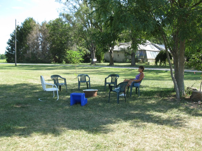

You can see the solar room in the background of this picture of the horse hang-out area across the road from the house (we have bonfires there at night a lot). I have a better solar room pic "somewhere" but can't find it now.

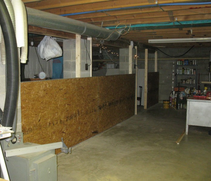

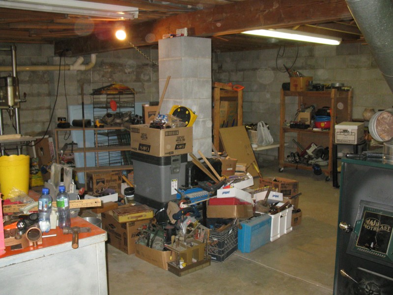

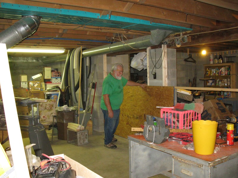

Some very early stage pictures
Post by robinson46176 »
[attach]15764[/attach]
Working on the dividing wall on the north-west wall of the shop (wall runs N-S). Still some stuff to move out but it is easy stuff now. That round 8" cold air return above my head is no longer used and will be taken out. The stack of boxes at the left side of the picture is a few of the empty boxes from our Xmas decorations and will go away in a couple of days.
I am not using a convential stud wall, it just isn't needed. I'm just using 2"x4"s lagged into the beam above on each side of the block post and a horizontal at the floor and another at the top of the OSB panel (4'). The bottom horizontal and the OSB are both 3/4" above the floor to keep either from absorbing any moisture from the floor. That gap will be closed by a plastic base molding.
[attach]15765[/attach]
My 510 is happily making sawdust. :)
The door in that wall will be a 4 foot door on the right side of that post at the far right. Then after the door is about another 5' of wall. The top half of the wall will just be some heavy, ultra clear vinyl sheeting. I have used it before for such things and it works very well. If I get into it with a board replacement is quick, easy and cheap. It is surprisingly tough stuff. The first time I used it I was concerned about dust and static but it has never been a problem. I realize that I could gain wall hanging space if the wall was solid all the way up but I am very claustrophobic and wanted to be able to see across the basements.
[attach]15766[/attach]
Not sure where the light splotches came from in the upper part of this pic.
Since I have not done the tool storage bit yet I just piled a batch of small tools around a post. It is all going to be happening fairly quickly now that the bulk of what does not belong has gone away. I still have an awfully lot of stuff to move from the other shop yet and today's snow will not help that. I may have to adjust my deadline again. :D
More pictures to follow as it progresses.

I see the makings of a great shop area developing. You have much more room, especially head room, than I normally associate with a basement.
I wish we were close enough that I could come there to be your go-pher.
Some of the walls appear to be damp. Is moisture in the walls a potential problem?

dusty wrote:I see the makings of a great shop area developing. You have much more room, especially head room, than I normally associate with a basement.
The walls are stained but dry. They became stained when my parents were still living here and the basement was neither heated nor air conditioned. The staining was from condensation rather than infiltration. My father used to run a dehumidifier in it but after he died my mother refused to run it. Since we have lived here we have heated it and ran the dehumidifier. In more recent years we have also air conditioned it which keeps it quite dry. As I put up my wall system for tool hanging (starting tonight or tomorrow) I am installing 1/2" sheet foam insulation behind it "just in case" to be sure there is no moisture migration or condensation into the wall panels. It is the blue stuff in the background of the last picture.

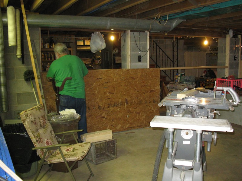

Here is a shot of the full length of the new wall. It's 26' long counting the 4' doorway.
I see that I should have turned more lights back on before taking the picture. I need to get the window area done now and close the part above the beam so I can keep the dust out of the rest of the house as I work on the shop.
[ATTACH]15769[/ATTACH]
Here it is better equipped. :D
[ATTACH]15770[/ATTACH]
