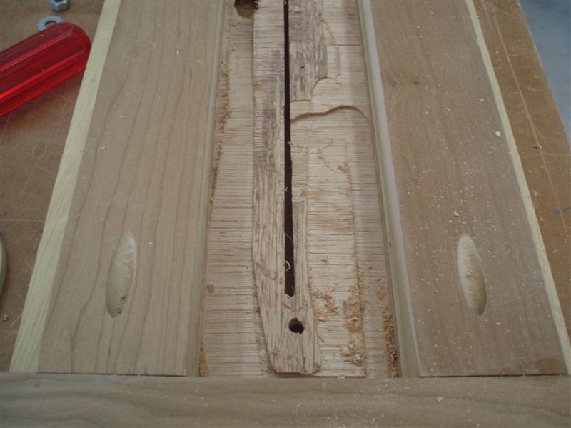

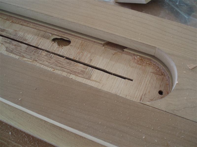

Today was a real learning experience. It started out to be one of those stormy days in the shop. The plan was to make the sled pictured (sorts) in the first post of this thread.
The task was to cut the slot for the ZCI into the bed of the sled using a plug router equipped with a straight pattern bit. I don't do a lot of plunge routing but I have done enough to give me confidence that this was an easy task.
I had already made a template of the ZCI so all I had to do was attach the template and route away.
Route away is exactly what I did but I could not get a smooth bottom. More than once, I had routed the entire area - its getting deeper and deeper. Was only suppose to be 1/4" and I am routing in 1/2" plywood.
I'll post a picture or two later but eventually the inevitable happened. The router bit broke through; yes, broke through. It is now cutting more than 1/2" deep; a 1/4" or more deeper than I have the router set for.
I ruined my sled but I learned a valuable lesson.
LESSON LEARNED: Make certain that the router bit is secure in the collet. I was using an adapter because the only pattern bits I have are with the small shaft. The collet was not secure enough to hold the router bit tight. It was moving in and out thus the bottom of my routed area was everything except smooth.
Sled will be done another day.

- Miscellaneous 023 (Custom).JPG (63.2 KiB) Viewed 3102 times
- Miscellaneous 024 (Custom).JPG (57.2 KiB) Viewed 3097 times
