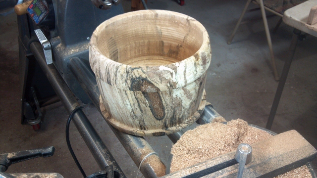

My second green bowl went without a hitch. I mounted it on my Nova Chuck and had no issues like my first one. One problem with my Universal Tool Mount is that it gets in the way of my work and I can't get close enough to the tailstock as suggested to start turning the inside of the bowl. Is there some type of extension for the live center so it can span the distance required to reach my blank.
[ATTACH]20143[/ATTACH]
Mounted on my Nova chuck with no breakout this time.
[ATTACH]20142[/ATTACH]
This will be my last posting on this thread, I think I have the hang of this turning and will not bore you with a string of photos.

Fred, Shopsmith has an extension for the live center that is used with the lathe duplicator. You also can get a Morse Taper #2 to Morse Taper #2 extension from machine tool suppliers like Enco -- http://www.use-enco.com/CGI/INPDFF?PMPA ... M=214-8702

Art, thanks for that information. I just ordered 2 from SS. That should extend my live center far enough to reach over the UTR and Lift Assist brackets.

I'm actually jealous of the wood, that is some pretty stuff you got there Fred.
Nice spalting there.
Nicely turned as well. Good job Fred.
