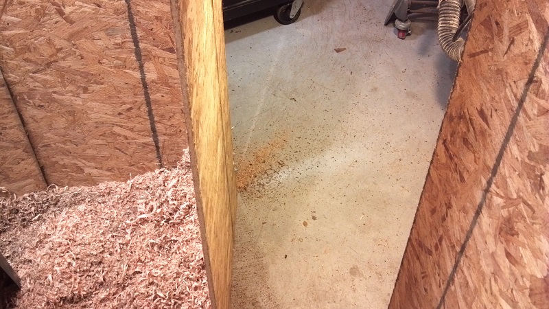

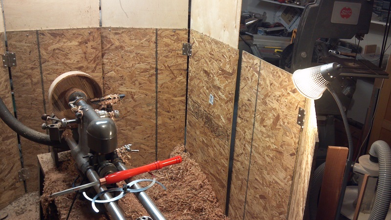

Success
Adding the panel extensions solved my issue of chips flying over my original walls.
[ATTACH]22916[/ATTACH]
99% of the chips and shavings were contained by the extensions I added to the panels.
[ATTACH]22917[/ATTACH]
A few chips found their way through the gap between my panels. Otherwise there were no chips or shavings scattered all over the place as before. Clean up was much faster tonight.

And the panels previously only contained 1%?:eek:;)fredsheldon wrote:Adding the panel extensions solved my issue of chips flying over my original walls.
- fredsheldon
- Posts: 1175
[quote="JPG40504"]And the panels previously only contained 1%?:eek:]
The small chips from the dry outer bark were flying up and over the original walls. Probably about 5% were flying all the way across my garage and landing on everything. After spending hours this past weekend cleaning up all my shelves I decided to do something about it. Now there are no chips flying anywhere other than against the new higher panels other than what is getting through the small spaces between the panels. Picky Picky
