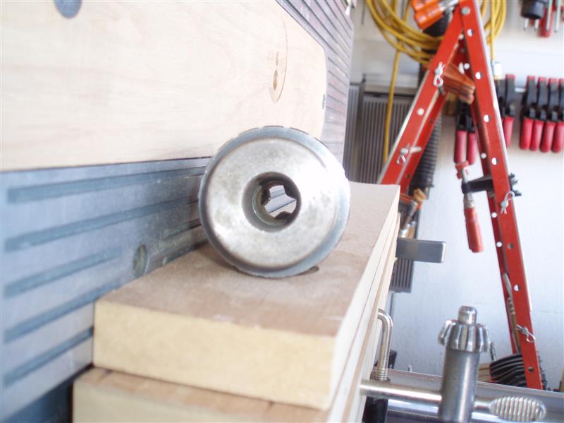

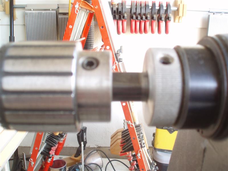

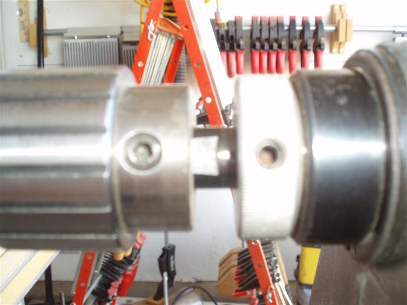

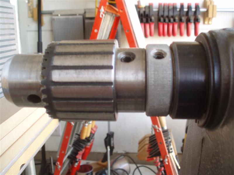

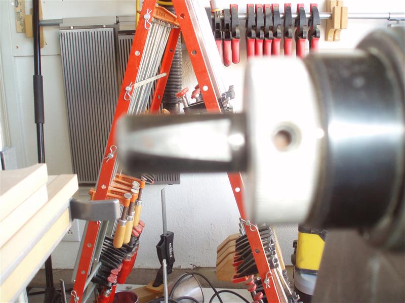

Not knowing how familiar you are with the shaft and the chuck, I thought maybe these photos would help you to envision what you are up against.
[ATTACH]20606[/ATTACH]
[ATTACH]20607[/ATTACH]
[ATTACH]20608[/ATTACH]
[ATTACH]20609[/ATTACH]
[ATTACH]20610[/ATTACH]

Well, thanks for the photos Dusty. You’ve changed my whole outlook.
1- The spindle shaft isn’t quite as long as I’d feared;
2- The chuck may be hollow all the way through.
Looked solid when I checked, but I’ll check again for any sign that it’s open on the other end. If so, I’ll definitely lean toward the "puller" route.
(At this point I’m less concerned about the chuck so long as I can remove it without damaging the spindle.)
Gonna run to look again now.
