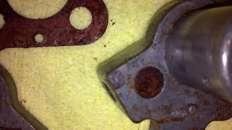

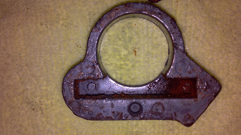

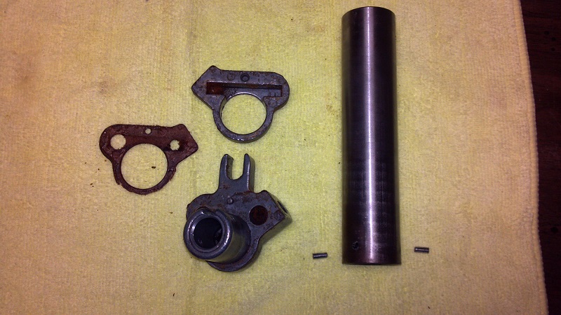

Well, this is gonna take some explaining!!!!
[ATTACH]21727[/ATTACH]
I gotta shaft, but no balls! :eek: :eek: :eek: :eek:
[ATTACH]21728[/ATTACH]
[ATTACH]21729[/ATTACH]
Should I feel gypped, robbed????

pieceseeker wrote:Well, this is gonna take some explaining!!!!
Pun not intended ? :eek:

Seriously though, is this a defect, design change, or other. :confused:
Maybe someone forgot to put in the balls and springs.
Maybe engineers decided the check valve design was too restrictive considering the low volume and pressure of air involved.
Or just too prone to plugging and generally fouling up.
