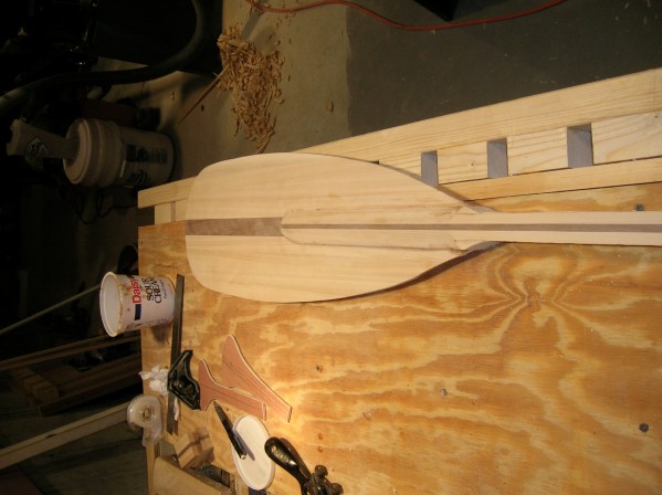

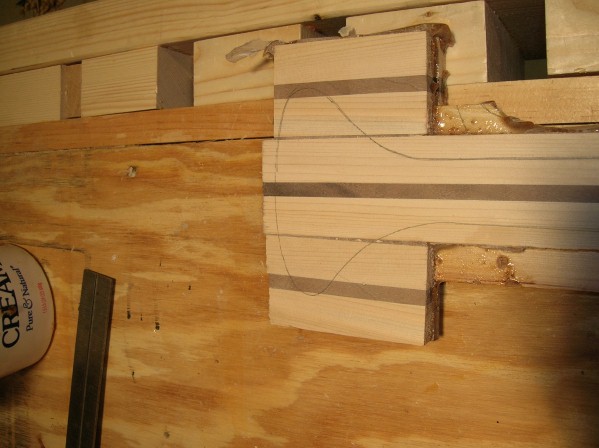

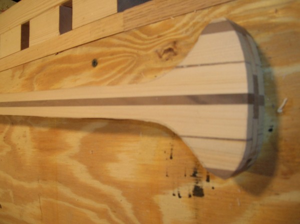

Here are some updated photos of the paddles, splines were shaped with a spoke shave and rasp, the epoxied in place. Everything sanded and then cut to rough dimension. I've got to pick up a 3/8" round over bit to bring the shaft and handle closer to size the will finish with sand paper. Been toying with the idea of having names and maybe an image wood burned into the blade before glassing, cost and time will figure into that. Sorry for the quality of the photos, Im as good a photographer as I am a carpenter.
- Cedar Strip Paddles 002 (Custom).JPG (73.53 KiB) Viewed 3630 times
- Cedar Strip Paddles 003 (Custom).JPG (55.9 KiB) Viewed 3623 times
- Cedar Strip Paddles 004 (Custom).JPG (72.11 KiB) Viewed 3630 times

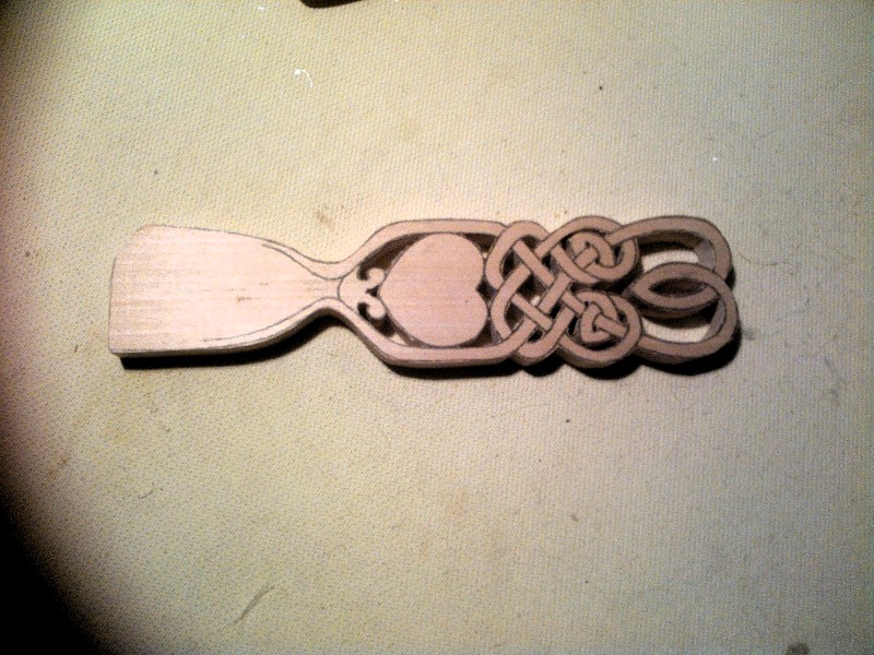

Check out this method for transfering an image onto a project from a laser printed page or a photocopy. Lable Your Projectsnewportcycle wrote: Been toying with the idea of having names and maybe an image wood burned into the blade before glassing, cost and time will figure into that.
I have used it once myself, so far, to transfer a pattern onto a spoon blank.
Here is a photo of the blank after I cut it out on the jigsaw, my wife hasn't carved it yet. Worked great.
[ATTACH]23251[/ATTACH]
- spoon transfer.jpg (160.35 KiB) Viewed 3722 times

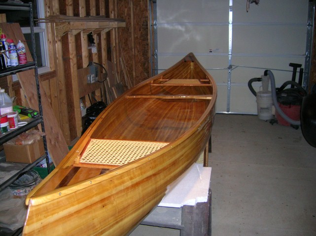

Finally Complete
[ATTACH]26420[/ATTACH]
Well, not to Hijack Algale's canoe build thread, here is the completed boat. I started June 1, 2013, and now its done. Been an interesting journey. I've learned alot about myself and my limited skills have increased greatly. It's also started a passion for wooden boats and increased my admiration for wooden boat builders. The shopsmith was an invaluable tool.
- Canoe Build 2014 Complete 004 (Small).JPG (95.3 KiB) Viewed 3630 times

Nice work. So now what happens. Does it sit on display for all to admire for a couple of years, then hit the river to run the rapidsnewportcycle wrote:[ATTACH]26420[/ATTACH]
