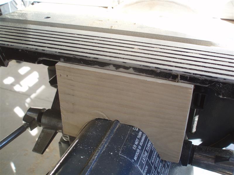

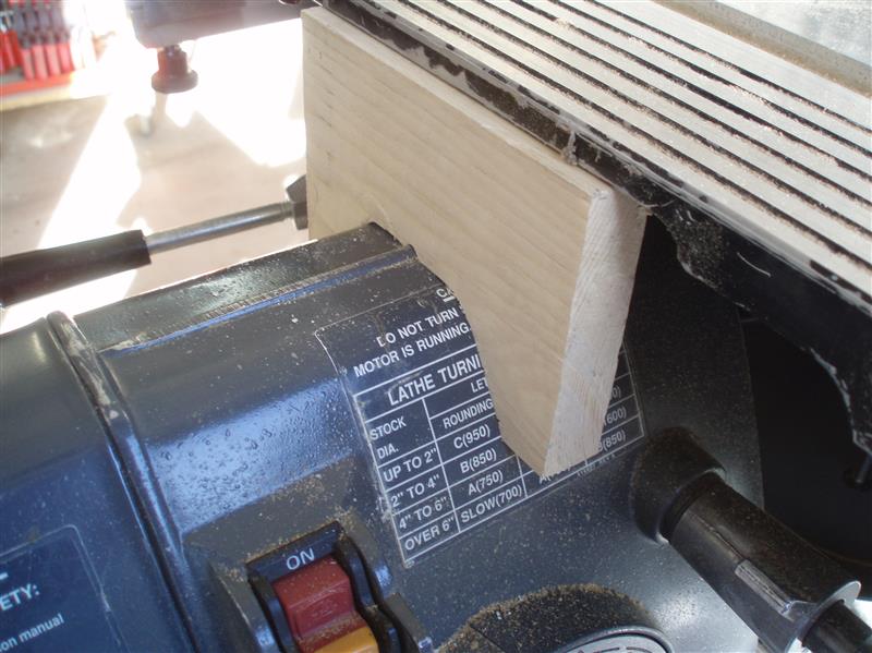

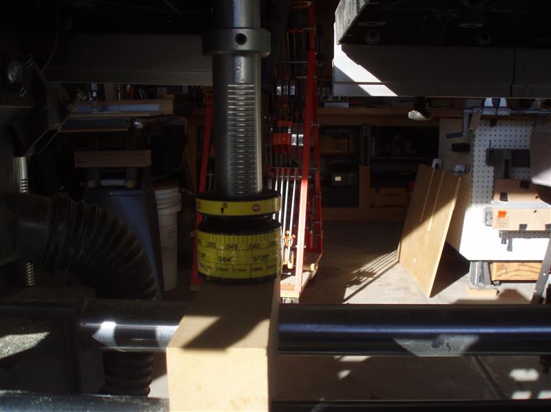

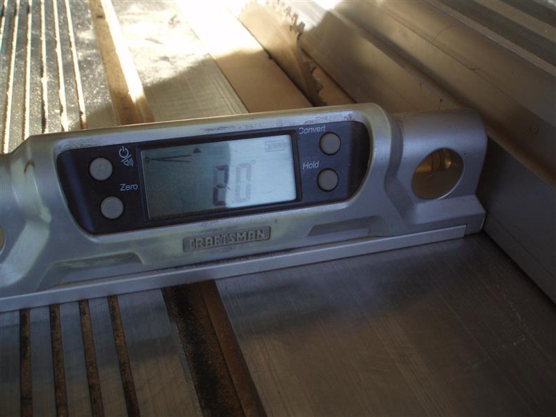

As stated in another post of mine within this thread, I cut a few pieces to verify my comments. While doing that, discovered that the pieces were not consistent. Why? This is such a simple task. They should all be identical.
Well, they weren't. More practice revealed that 1) the table tilt had changed and 2) they were not the correct width at all points along their length.
The table tilt changed and I did not maintain contact with the fence throughout the entire cut.
Easy fixes. First maintain control of the work piece. These are small pieces, use a feather board and a push block.
Table tilt fix is easy as well. All you have to do is prevent the table from moving after it is set. The pictures tell how I did that.
[ATTACH]24121[/ATTACH]
[ATTACH]24122[/ATTACH]
[ATTACH]24123[/ATTACH]
[ATTACH]24124[/ATTACH]
Most of the time a slight movement of the table is not an issue. However, with a small angle like this, I found that it changed. I don't know that that caused a significant variation but leaving it to chance is not my manner.
With the bridge across the headstock on one side and the Adjustable Stop Collar on the other, it does not move once set.
This particular setup (bridge height) yields too much exposed blade for this task (about 2 1/2") but it makes the point. I will deal with that later.
