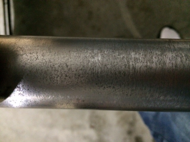

Sight unseen, I think a few swipes with sandpaper(or file if really proud) would bring it back closer to 'normal'.shaun.farmer wrote:Front to back on the left third of the table. When I asked the guy who have it to me, he said it was used for storage and things were piled on top of it. It makes it a challenge getting the motor connected to the bandsaw.

You will NOT need a file:)
320 or 400 grit should work.
The bench (lower) tubes can always be painted like the early Greenies bench tubes. I find the pits in the way tubes will always look bad but as long as the outer surface has been sanded and waxed, the headstock and carriage will slide on these tubes. Keeping the pits from rusting again may be a problem over time. You may want to look for some shiny way tubes on Ebay if looks is important.

Don't sand too much. Those way tubes align EVERYTHING on the ER. If you remove too much, the alignment will be off. Don't try to eliminate the pits, they will turn into pockets to hold lubricant.
One of the members at the ER Group, uses mineral oil on ALL his surfaces. He is in the Philippines, close to the beach, and has very little rust issues. He also doesn't worry about old rust or pits.
Think about this one, say your front way tube has some pits, and you sand them out. Look at your ER. The carriage lock is on the bottom, and the headstock lock is on the top. If you remove 10 thousandths, once you lock everything down, you're now off 20 thousandths. That is the thickness of a playing card.

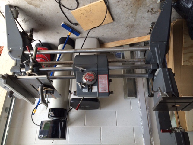

How did you attach it to the ceiling?shaun.farmer wrote:Cleaned up.
Haven't touched the lower tubes or the planer but this looks like a totally different machine now.
