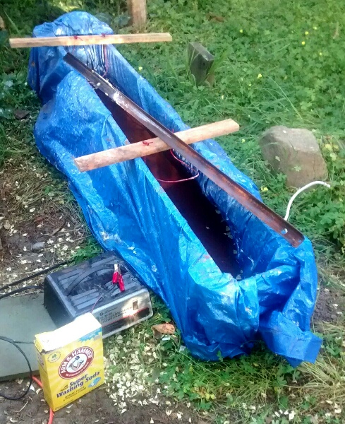

Let me qualify my suggestion to try electrolysis: I have little to compare it to. I used naval jelly a few times. It didn't seem to work well on some old planes last year. No idea why. Perhaps I didn't degrease them. I tried electrolysis for the shopsmiths and was rather surprised at how well it worked. Best of all... It is cheap! $3.50 or so for a big box of washing soda at ace hw, a tarp, some scrap wood and an old, "dumb" style car battery charger. Made a tub:
[ATTACH]24970[/ATTACH]
Actually made wider tub and did legs, tubes from one ss, had to move it to back yard and made it narrow as seen. You can keep reusing the washing soda mix, just add water to replace any evaporation. And probably remove the snails. Somehow a couple ended up flotoolg.
I just tried the naval jelly again yesterday ADHD it worked great. I can't afford the large supply of chemical rust remover but I'll use a combination of the two: chemicals on batches of small parts so I don't have to bother finding a way to string then together or year separately, electrolysis for large posts or a few small parts.
I do need to address the rust on the tube interiors since electrolysis didn't touch it.

To clean the rust from inside a tube using electrolysis put a piece of steel down the center of the tube. Rebar should work nicely for this.
The lye and zinc method may work for this. I've cleaned heavy rust off cast iron using this method but not inside a tube.

I was also lucky enough to get four quarts of Evaporust really cheap at the Lowes closeout. In hindsight, I should have scooped up the whole shelf full -- the stuff is great.rbursek wrote:When I started with the pretty clean Greenie I was at HF after reading here about the de ruster, If I remember right it was 27$ a gallon minus any coupon, around 10$ a quart. To rich for my blood!!!!!
Even at full price, Evaporust is not as expensive as it seems, because you can use it over and over again. I'm still using my first quart, and it has derusted dozens of items. My other three quarts have been used only once or twice, when needed to submerge a large item.
