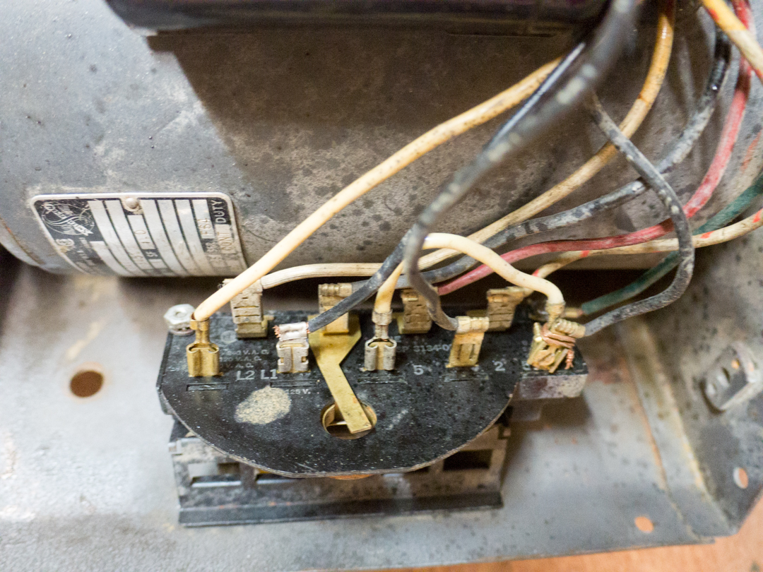

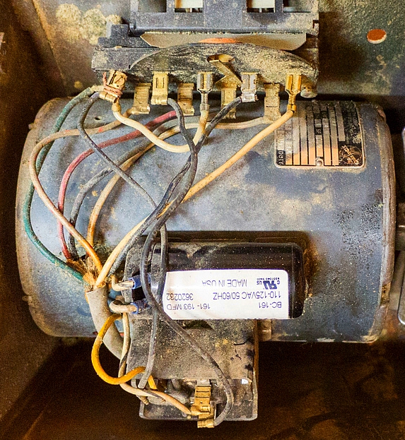

It still blows the breaker if I run it in reverse. Any thoughts? All wiring is up to snuff per the Mark VII Parts Manual diagram with an A.O. Smith motor.

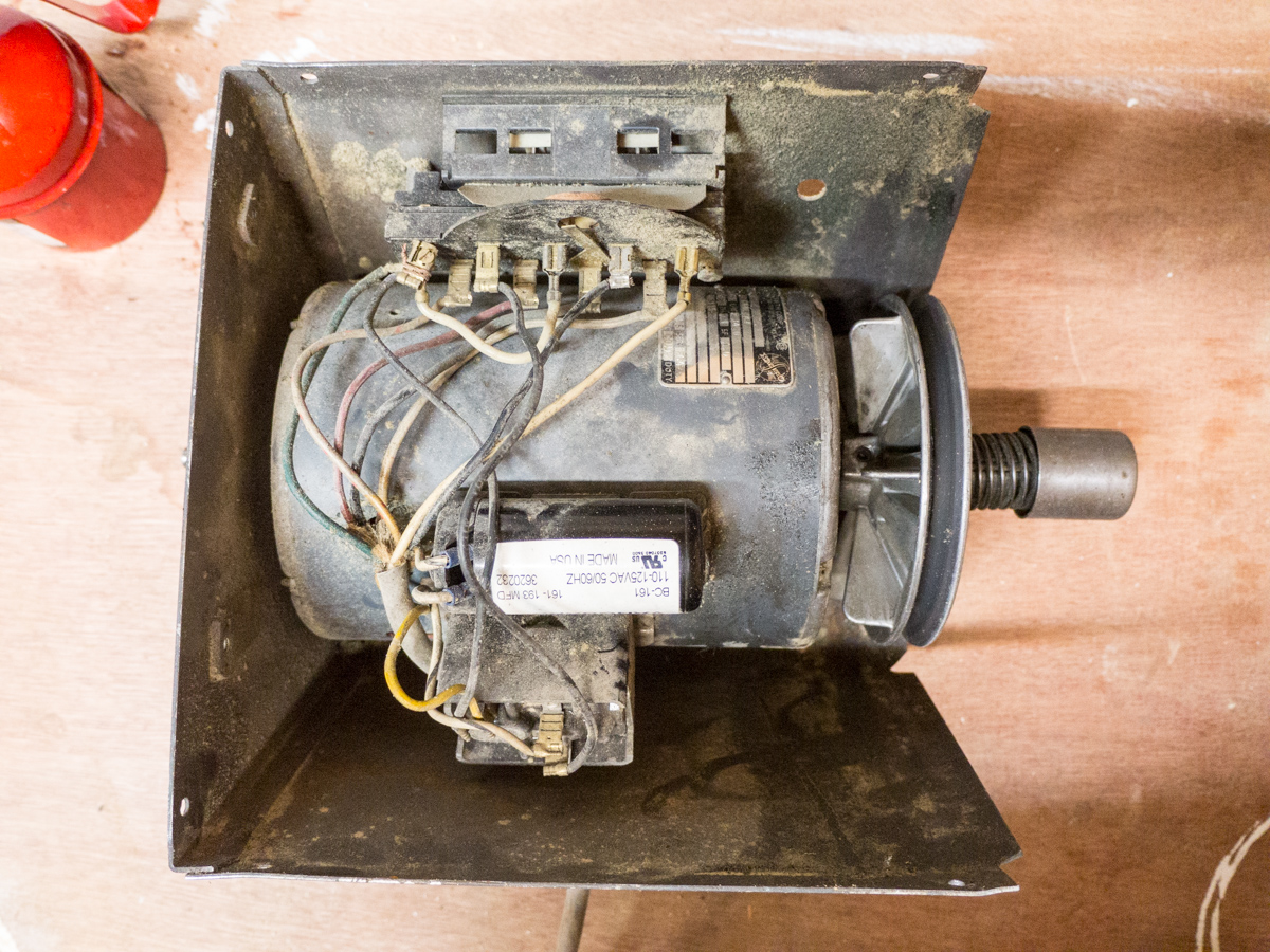

The motor off the headstock.

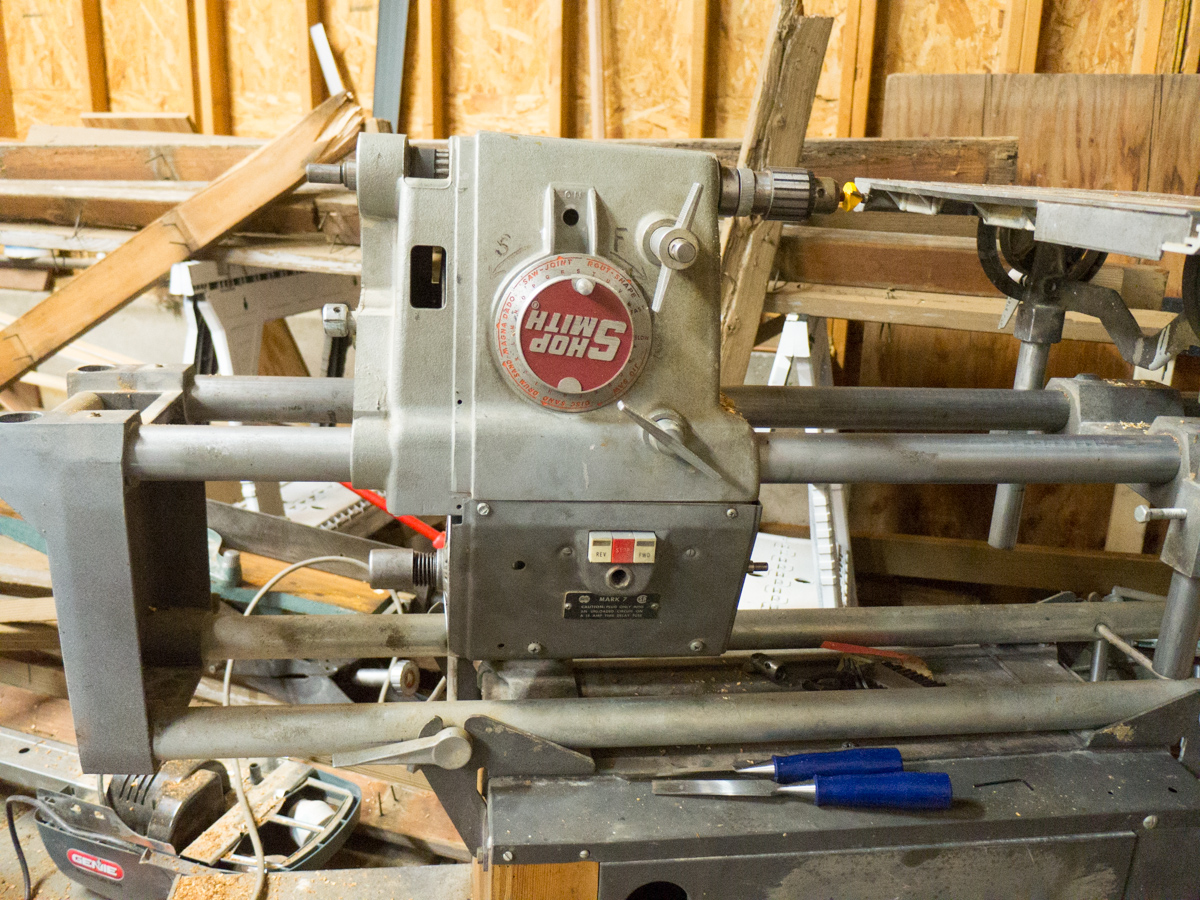

The beast...Sitting backwards on the stand. As I was muscling this myself, it will remain there until I have help or a whole lot of gusto

If that is a green wire from the power cord wound around the leftmost "5" terminal, it should be connected to the MOTOR frame. :eek:
There should only be the "5" to "5" jumper and a wire going to the "5" terminal on the start relay. Relay "5" terminal also has the yellow motor wire connected.
All the other wires appear connected correctly.
P.S. You are missing the lamp. ;)
P.P.S That is I believe a tapped hole in the motor frame directly below that "5" terminal. The ground wire belongs there. ;)

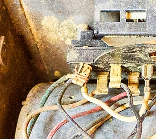

Thanks, the ground was a question mark for me, it isn't on the actual terminal, but still not properly grounded as you can see in this picture from a different angle. Any thoughts on the reverse blowing the breaker? Think this could be related?
Thank you for the response, very glad I found a resource like you guys

Re: Mark VII
hammerforce wrote:Thanks, the ground was a question mark for me, it isn't on the actual terminal, but still not properly grounded as you can see in this picture from a different angle. Any thoughts on the reverse blowing the breaker? Think this could be related?
No. The ground wire there should not cause reverse problem.
Is the motor humming prior to the breaker tripping?(do not do often/repeatedly).
If so the start winding is not being switched for reverse. To verify that,
(only activate rev in the steps below!!!!!!!)
Do the following ONLY if the motor does hum prior to tripping breaker in reverse.
Unplug power cord.
Activate REV switch.
Jumper terminals T9 and 5.
BRIEFLY insert power plug.
If it starts, the switch is not closing terminals T9 to 5(outer).STOP
If it just hums, unplug the power cord.
Jumper terminals T5 and 2.
Again briefly insert power plug.
If it starts, the switch is not closing terminals T5 to 2.
Unplug power cord.
Remove the jumper between terminals T9 and 5.
If it runs, only the T5 to 2 switching is defective.(failing to 'make')
If it only hums, both the T5 to 2 AND the T9 to 5 switching are defective.
Remove ALL added jumpers.
If you are adventuresome, the switch can be taken apart to determine/correct(maybe) reason for failing.
Make sure you understand the jumpering above(it takes the place of the switch making contact).
REPEAT Only do this with the switch set to REV and if the motor hums!!!
"Briefly" means not long enough for the breaker to trip, but long enough to determine the motor either hums or starts. If it only hums it is very important to make "brief" as short as possible.
