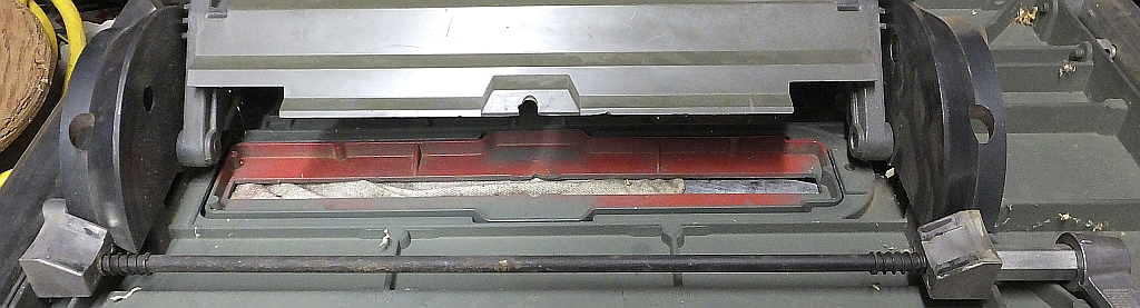

[ATTACH]26763[/ATTACH]
Pix is of a 510 reassembled, but not adjusted table.
Notice the trunions are against the bar pivots.
The clamp assembly consists of a threaded bar, two clamp shoes, two shoe return springs, a washer, a long(coupling) nut and the restrained hand lever.
That is all removed and sets below the trunions in the pix.
The rear shoe is secured(threaded hole) tightly to the rear end of the rod.
The front shoe is free to slide along the rod.
Both shoes are pushed away from the trunion by the springs when the clamp is 'loose.
As the lever tightens the clamping nut it squeezes the shoes towards each other and they both press against the trunions.
I think the pad backing up the trunion contributes only a small amount of resistance to tilting, but is to provide a backing to the rear of the trunion to limit any deflection.
So, if Dusty has that gap between the rear trunion and that backup pad the rear shoe must be interferring with something that prevents it moving all the way up against the rear trunion when the front is 'clamped'. Not understood is why the front clamps at all.
Perhaps the rear spring is broken/jammed in the rear spring bore?
With the clamp nut very loose, the rear shoe should move in/out with rod movement all the way against the trunion. Same for the front shoe in the reverse direction.
FWIW, the trunions are steel(hard) and the shoes soft(aluminum").
The surface area of the contact area of the shoes is reduced by having a raised area at each 'end'.
Sorry for any confusion with this post as initially 'posted'.

I think you have discovered that if the trunion bolts are tightened with the trunions not against the bar pivots, the clamp will not overcome the retaining bolts and move them so.(at least on yours!)
I think the rear trunion not moving is another indication that the rear shoe is not moving against the trunion. i.e. what ever is causing that lack of motion is causing the gap when tightened.
Something is interfering with the rod and shoe moving towards the rear trunion.(towards the front of the table).
Or the rod is too long, or the threads at the rear of the rod for the rear wedge don't extend far enough or the threads tapped into the rear wedge are too shallow....JPG wrote:I think you have discovered that if the trunion bolts are tightened with the trunions not against the bar pivots, the clamp will not overcome the retaining bolts and move them so.(at least on yours!)
Something is interfering with the rod and shoe moving towards the rear trunion.(towardsa the fronr of the table).

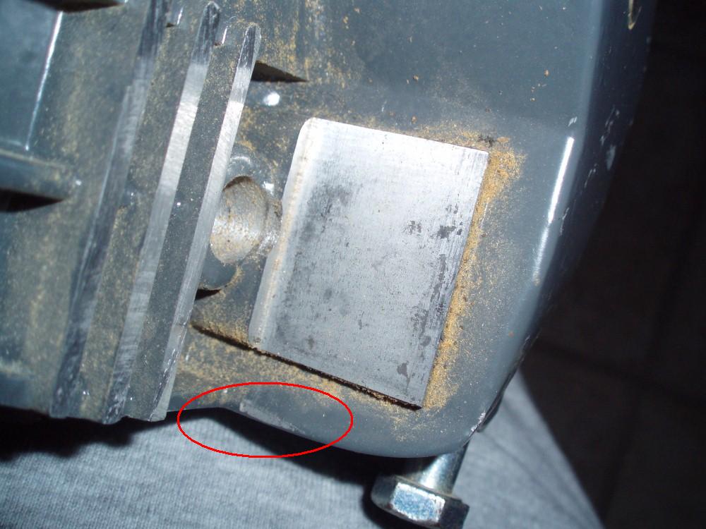

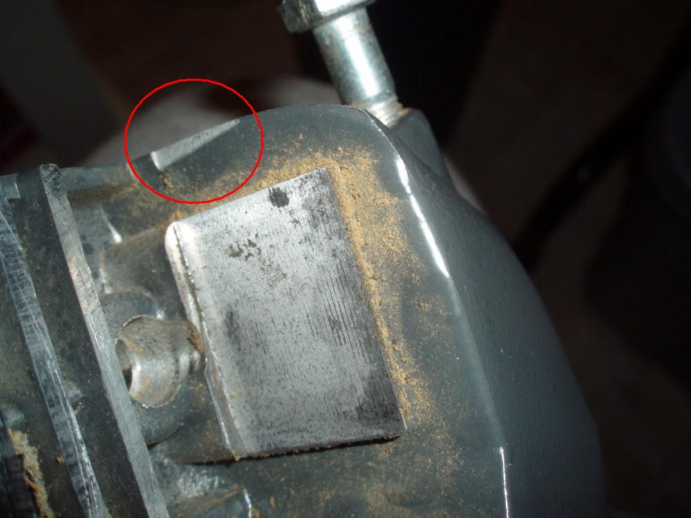

I still have not resolved the table tilt issue but I do believe I am making progress. I do believe that when a table slips it is because the brake shows have not fully engaged (the gap). What is preventing that engagement is still to be determined.
The circled areas in the attached images may (repeat may) be an issue or at least an indicator of the issue.
[ATTACH]26770[/ATTACH]
[ATTACH]26771[/ATTACH]
- Brake Shoe Wear 006 (Custom).jpg (87.51 KiB) Viewed 2687 times
- Brake Shoe Wear 007 (Custom).jpg (99.65 KiB) Viewed 2689 times
This gap was created by deliberately sliding the trunnions apart as far as they would go (with the four trunnion bolts loose) and then securing the tilt lock. The front shoe is making contact with the trunnion while the gap remains as shown on the rear trunnion.JPG wrote:Shhh! Maybe Ed will miss this thread!:rolleyes:
That gap looks bigger than what I would attribute to the 'hole enlarging'.
Why the rear shoe is not pulled into place is now the question.
