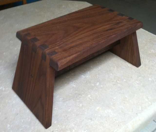

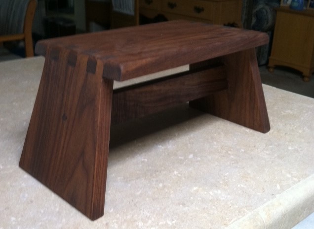

After debating with myself for a while, finally decided to make a footstool to go with the rocker. So a few days later - - -

Darn if this doesn't make me wish I was a woodworker.
Excellent job!

Pretty cool stool. How do you do angled dovetails (or are they box joints)?

GREAT Looking footstool, Chuck.

Didn't think I had time to lay out and make angled dovetails, so these are angled box joints. 14 degrees. Tools were dado blade, scroll saw and bench chisels. Scroll saw was used to get the slope. Just had to straighten and smooth a bit with chisels.
Rocker and stool will be delivered next week.
Need 3 days for the Watco stain to cure before putting on Varathane. So Varathane on Tuesday. Good thing it dries fast!
I dawdled too long before starting the stool. :( Because of problems getting the 14 deg. slope the fingers and slots got a bit longer/deeper than planned. As a result, the height is now 7 1/4" - was planned for 7 1/2"
