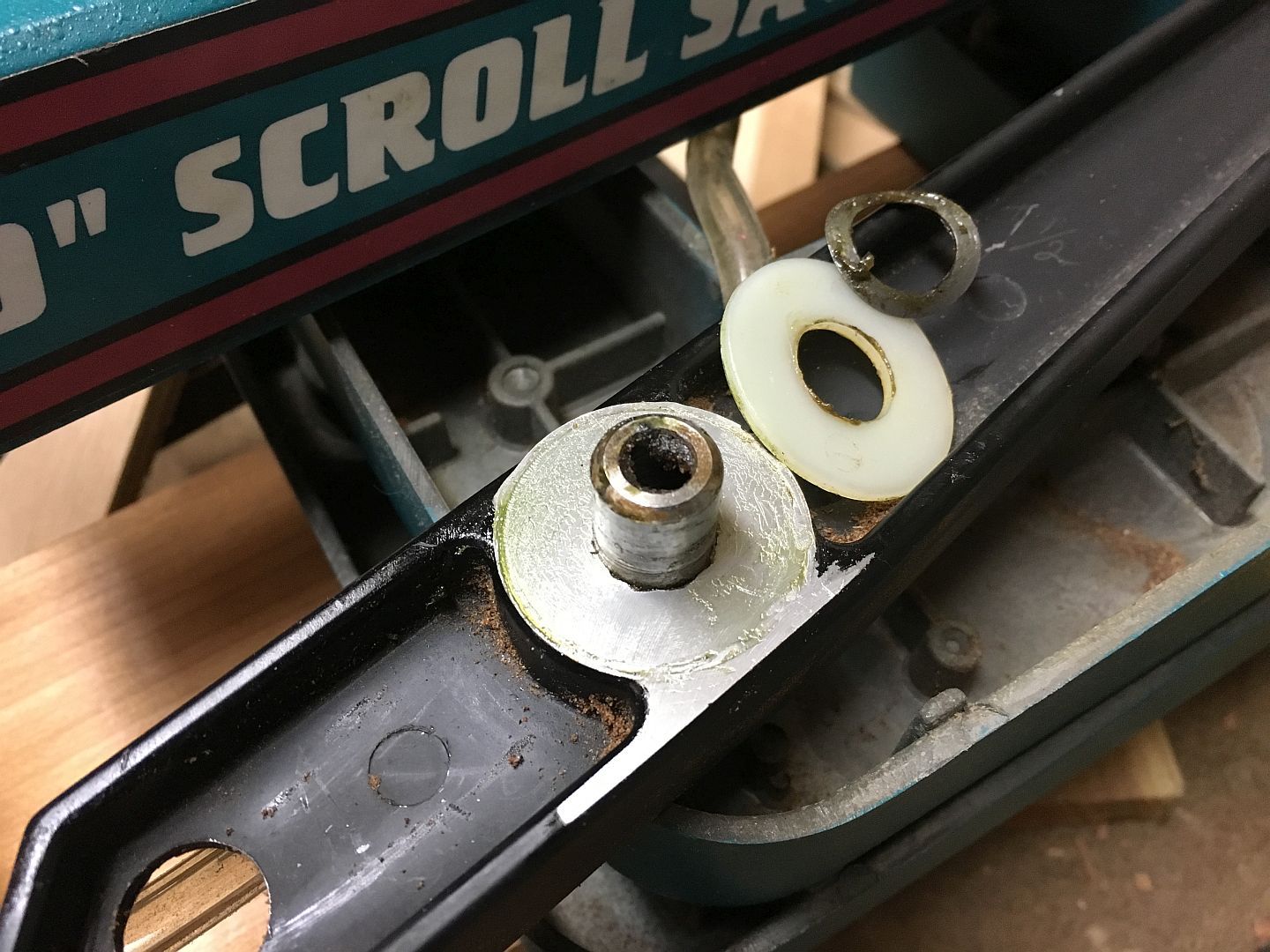

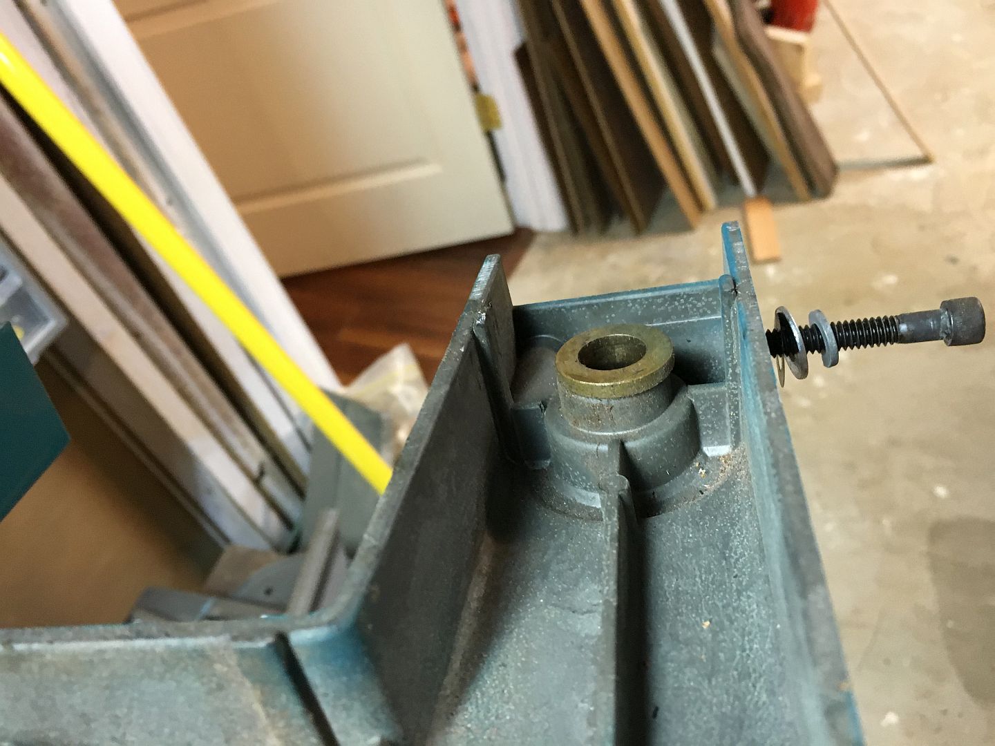

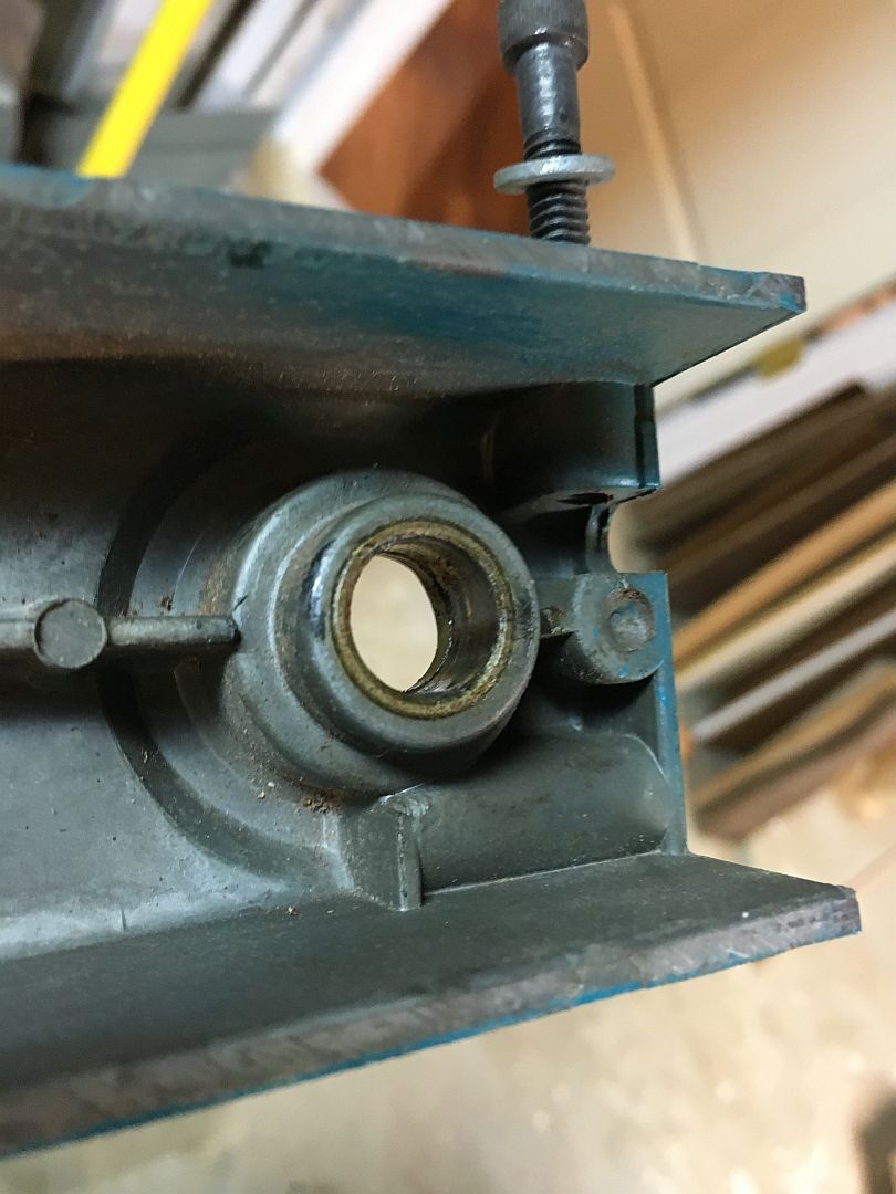

As I have further examined my teal scroll saw, I have discovered major changes between it and the grey scroll saw.
The grey scroll saw has bushings in the arms. Not so the teal scroll saw.
Instead, the teal scroll saw has bushings pressed into both sides of the upper housing castings. Moreover, the bushings are different.
Below is a photo of the right side (if you were standing from operator's position) upper housing casting. Note the bushing with a wide flange. It also isn't perfectly centered over the casting hole.
Both bushings on this right side are like this. Moreover, the side of the arm that contacts this side of the upper housing has nothing but bare metal riding against this wide flange.
Below is a photo of the left side upper housing casting. Note bushing has no flange and is pressed in flush with casting.
Both bushings on this left side are like this. Moreover, the side of the arm that contacts this side of the upper housing has a plastic washer and spring washer that are in contact with this side of the upper housing casting.
