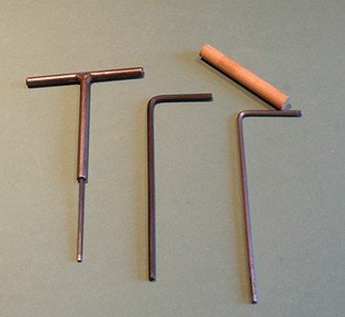

Here is a little trick that my father-in-law used.
He welded a handle on a allen-head wrench. That made it nice to hold and he could hang it on the front edge of the table.
I made one a couple years ago with a wooden dowel. I milled a slot half way down the length of the dowel and epoxied the wrench inside of that. Of course, I lost it somewhere and should make another one.
shopsmith 66.jpg (20.44 KiB) Viewed 5403 times
Sorry about the camera angle. The welded part is really square with the rest.
