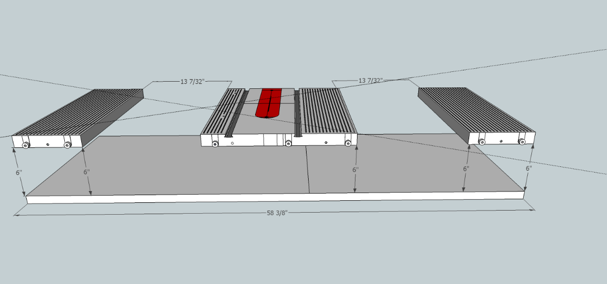

At first I did not understand what you were advocating. Then I set out to show how I would do it my way only to realize that you are doing the same thing but with different reference points.
My way: Left hand Extension Table offset from the Main Table (centered between Extension Table Locations). The dotted diagonals are the reference lines.
The short coming with this is that measuring at this level only tells you that the tables are square to one another. If the measurements are different, where do you start to fix that problem.
This is why I was so pleased when I had just the Way Tubes and Bases installed. That measure confirmed that the base was square. Now build up from there.

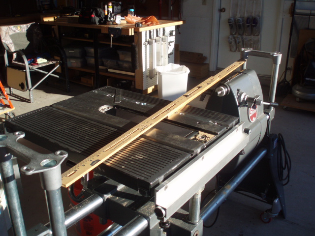

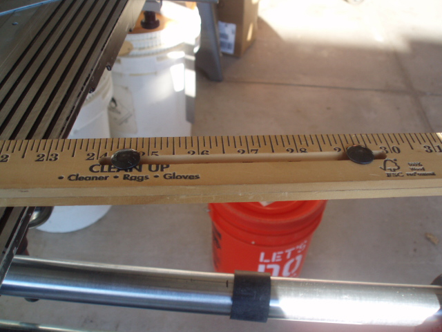

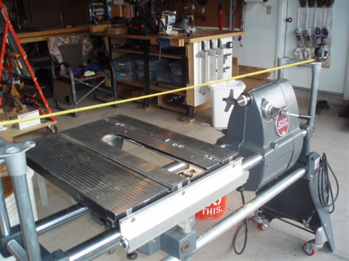

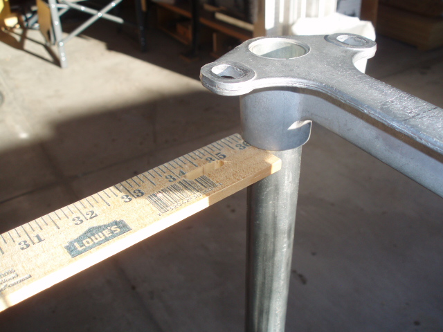

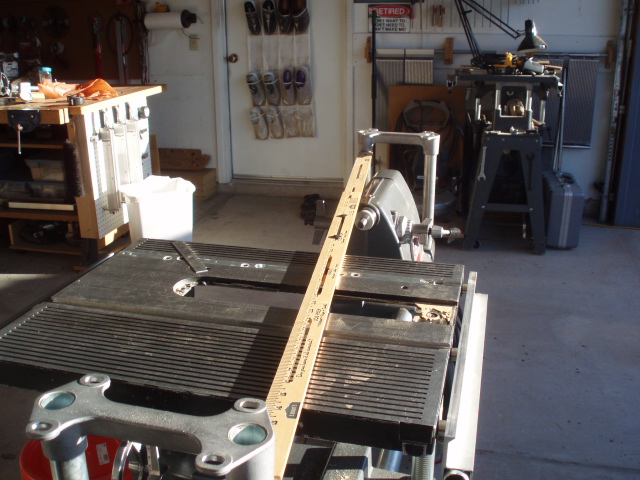

Here is another way to judge the squareness of the Bases and the Way Tubes. The Extension Table risers introduce still another variable, however.
Measured this way, I get 53 3/4" vs 53 11/16".
Do not compare these numbers with those previously reported. Recall that I had to relocate the Pivot Arms at final assembly. Relative squareness, however, is still comparable.
I now regret that I did not permanently record all of these same measurements on the original configuration. I made measurements but did not log my observations. This is not the way I was trained. There should be a log book that tells it all.
An addendum: I found my story board (made using two wooden yardsticks) to make this measurement. The yard stick storyboard (cheap at Lowes) is a better device for this sort of measurement than the tape measure. Again, I got slightly different numbers but still equals (indicating degree squareness).
