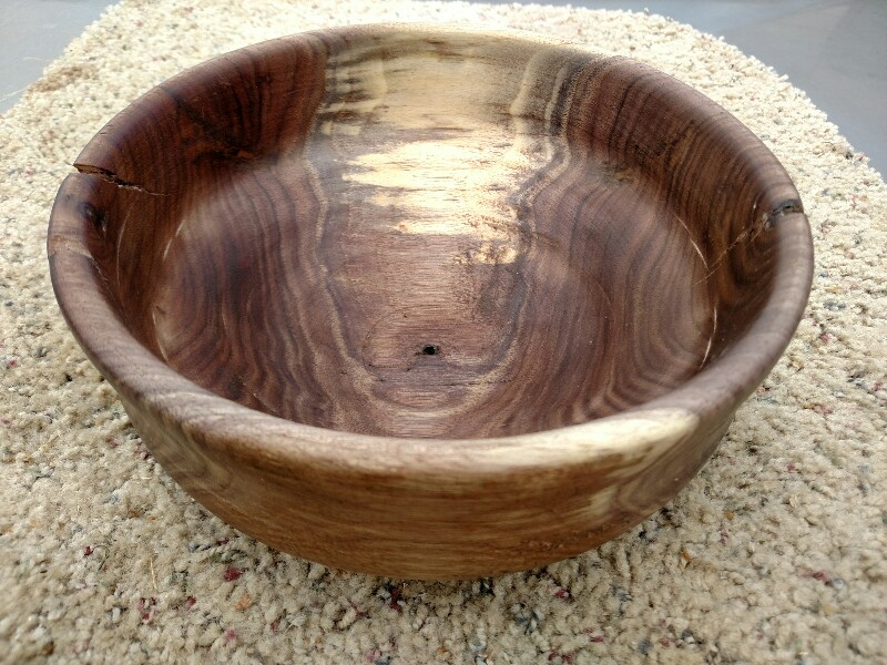

Here's my first attempt at turning a bowl

Dvsmith86, thanks for posting a photo of your first bowl. I was hoping that members here would post photos their turnings.
Very nice bowl. Much better than my first (second, third, etc...) bowl. I have trouble with going too deep too often. Is that what happened in the center of your bowl? I do that too often, and I have become well versed in making a little finial to glue in the bottom.
What kind of wood it that? Was that done with a 10er?

I learned many lessons turning that bowl. First, don't start with a whole round piece including the pith or heartwood. Second, remove the bark before turning. Third don't screw your stock directly to the faceplate - use a glue block with a paper joint. I would have known these if I'd watched the many videos on YouTube and looked at the ShopSmith site.Dansmith wrote:Dvsmith86, thanks for posting a photo of your first bowl. I was hoping that members here would post photos their turnings.
The wood is black walnut from a tree that floated into a friend's yard in our April flood. He was kind enough to cut it into four 6- to 8-foot-long chunks and brought it to me. It was so waterlogged that when I first started turning that chunk, water sprayed massively. I quit, let it dry for about a month, then over the course of about three weeks turned the bowl. Yes, it was done on a 10ER using "bench chisels" not turning chisels. Maybe for Christmas I can get some real lathe gouges, chisels, parting tool and so on.☺

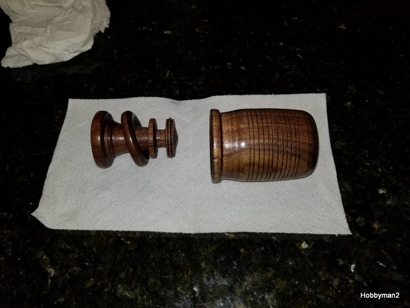

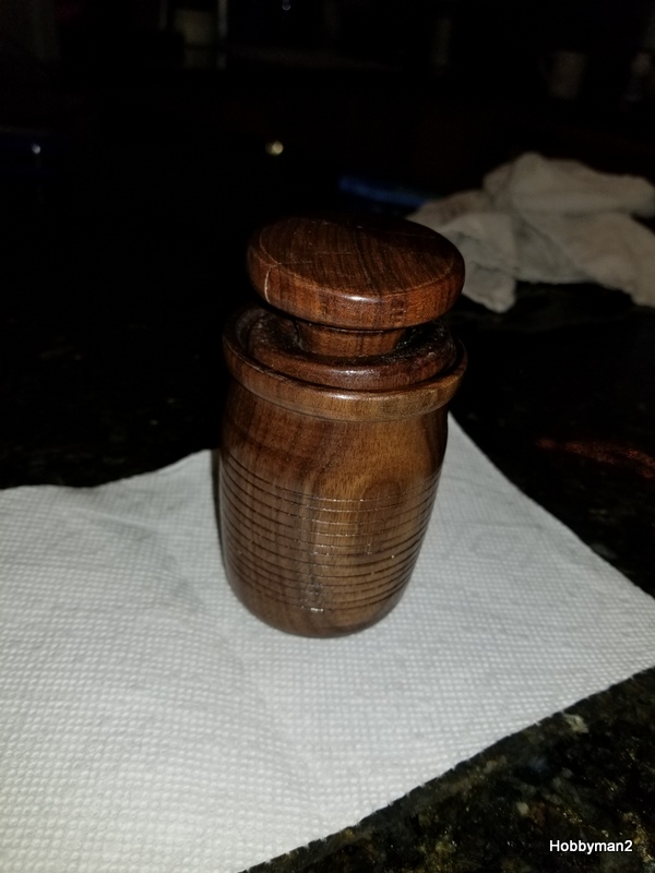

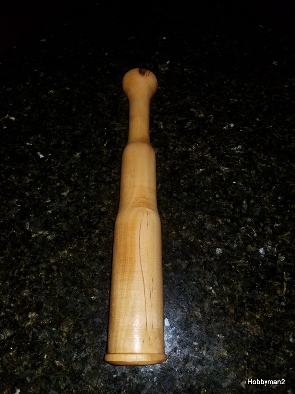

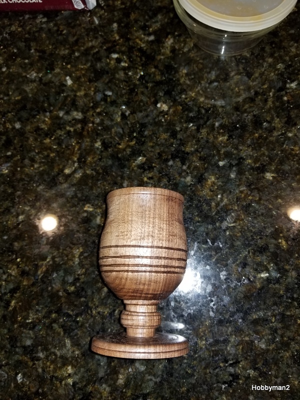

I dont have a er but here are a couple turnings

Thanks for posting your photos, Hobbyman2. Very nice turnings.
