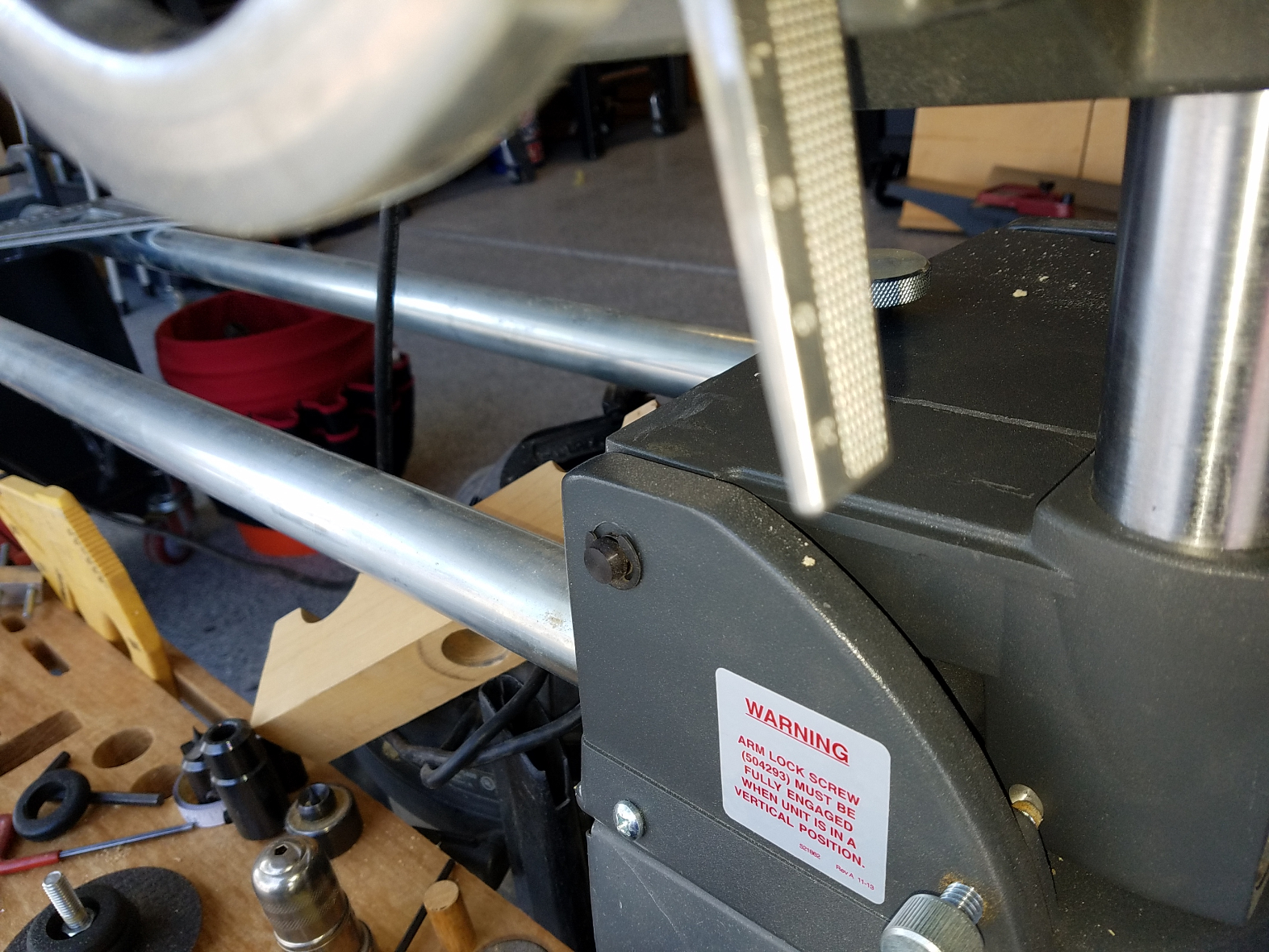

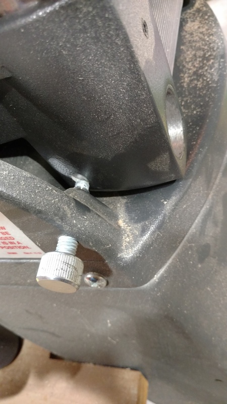

Sconi may never come back to clear up this mystery but I have given it some more thought anyhow.
I now have doubts about the images that we have seen. I am not convinced that they all depict the machine at the same time.
Sconi's safety lock pin..jpg (116.38 KiB) Viewed 11701 times
This image shows the relationship of the safety lock pin and the indenture in the Pivot Arm where it seats. Comparing this shot with a similar view from the OP, I would conclude that the Pivot Arm is fully rotated to the drill press mode; however ----
I do wish we could disconnect his lift assist to see if that changes anything.
Re: Drill press won't go high enough for lock to work
dusty wrote:Sconi may never come back to clear up this mystery but I have given it some more thought anyhow.
And this pix posted to this forum
sconi ss forum pix #3.jpg (47.96 KiB) Viewed 11691 times
I share your skepticism that all three(this forum posts)pix are of identical positioning. It simply does not 'compute!!!'.
And the title of the thread is certainly misleading as we saw a picture of the lock locked.
Could this be a catfish post?
