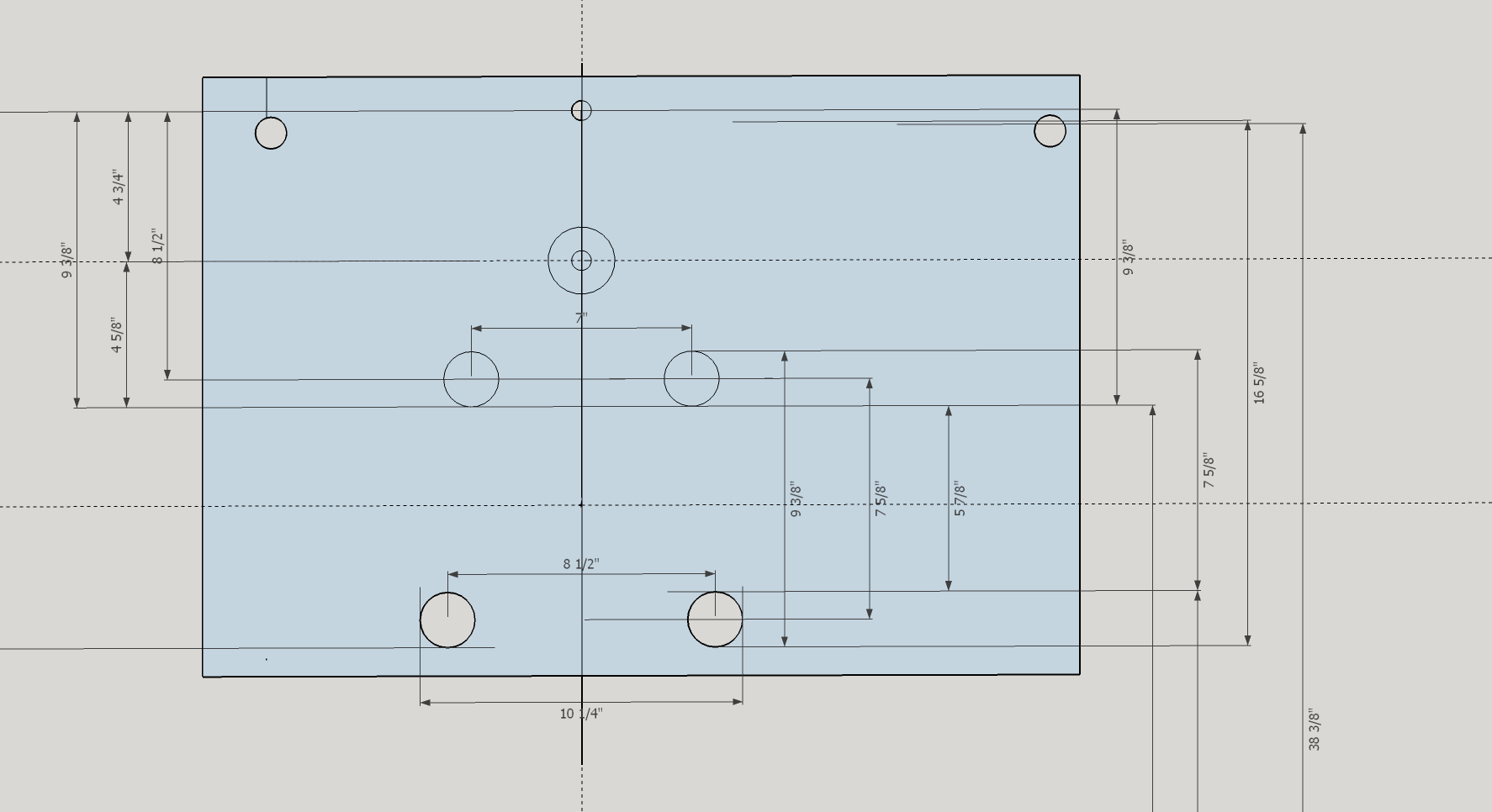

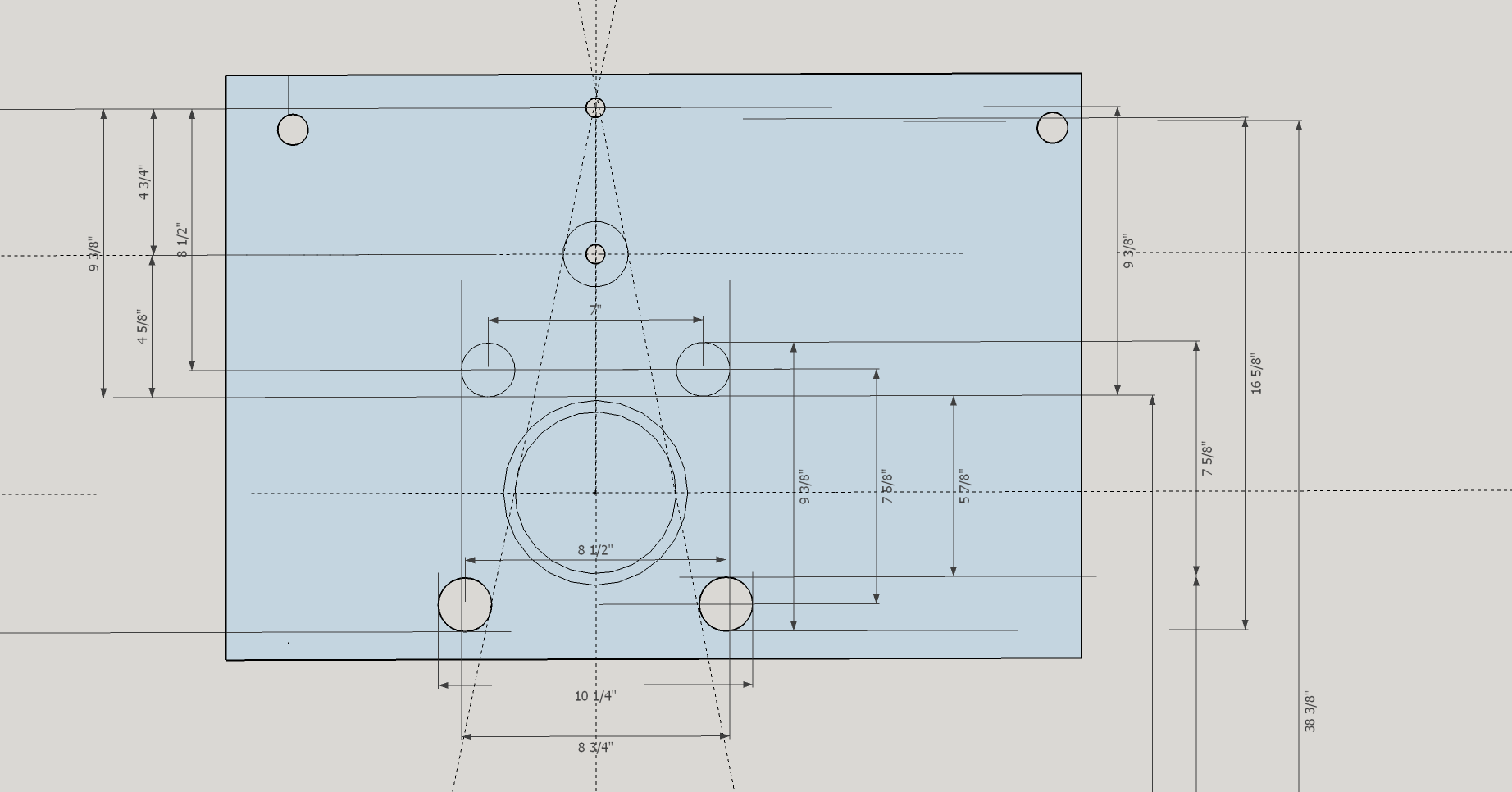

Just to give you a different perspective:
Nothing is specifically identified. Prepared for my own needs. You will have to use your imagination.
The dashed lines forming a triangle mark the path that the belt would be on.
Good luck. Hope you can avoid buying parts.

I tore into my vintage specific(sorta*) "A" headstock and found the following.
The motor IS off set towards the operator side by about 5/16"(a straight edge laid against the operator side of the main and idler shafts intersects the center of the motor shaft).
The v belt is riding slightly above the outer rim of the motor pulley at "fast".
The belt clears the way tube by about 1/4".
*The main and idler shaft are poly-v.
*However the motor has been spaced up off the motor pan by 1/4" to allow using a stock 26" belt. I do not think that affects the other details significantly although it may decrease the offset(standard belt would be further off set very slightly).
Does not explain a belt rubbing the tube, but does clear up the offset is 'normal'.

Re: V-belt replacement
Very interesting JPG. So it would appear the mis aleighnment is normal. However I'm confused how the belt can help but rub when running at high position on the motor sheve.
