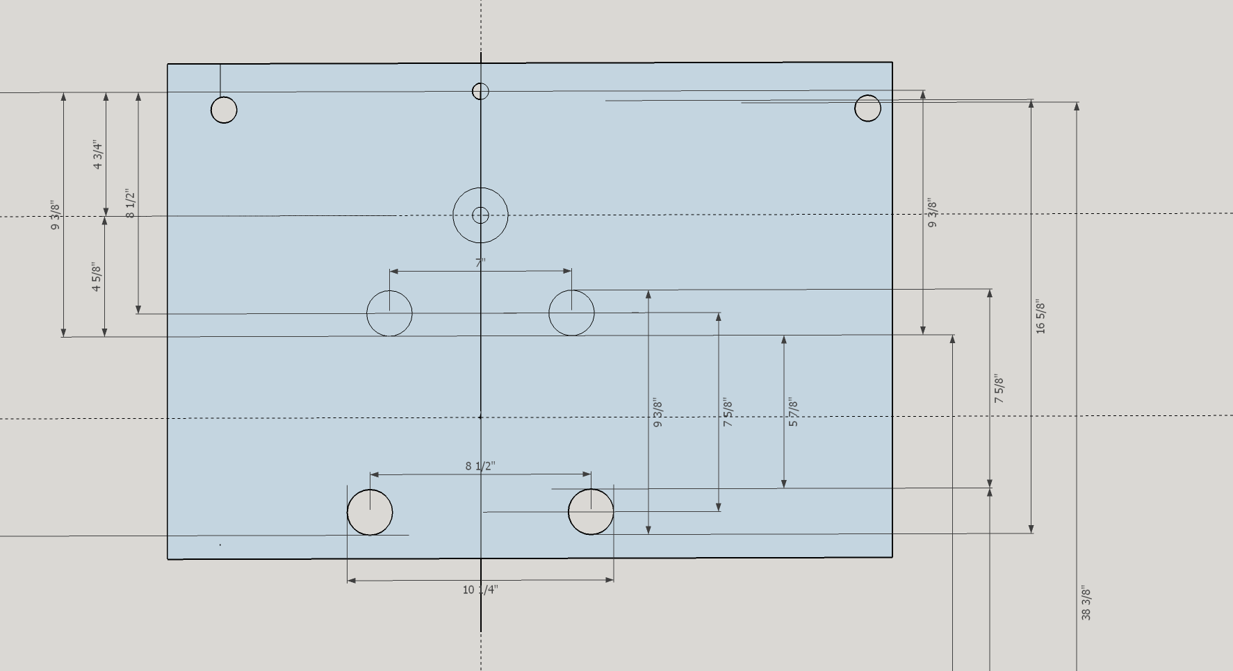

Just to give you a different perspective:
Shaft and Tube Relationships CORRECTED COPY no reference lines.png (50.87 KiB) Viewed 14693 times
Nothing is specifically identified. Prepared for my own needs. You will have to use your imagination.
The dashed lines forming a triangle mark the path that the belt would be on.

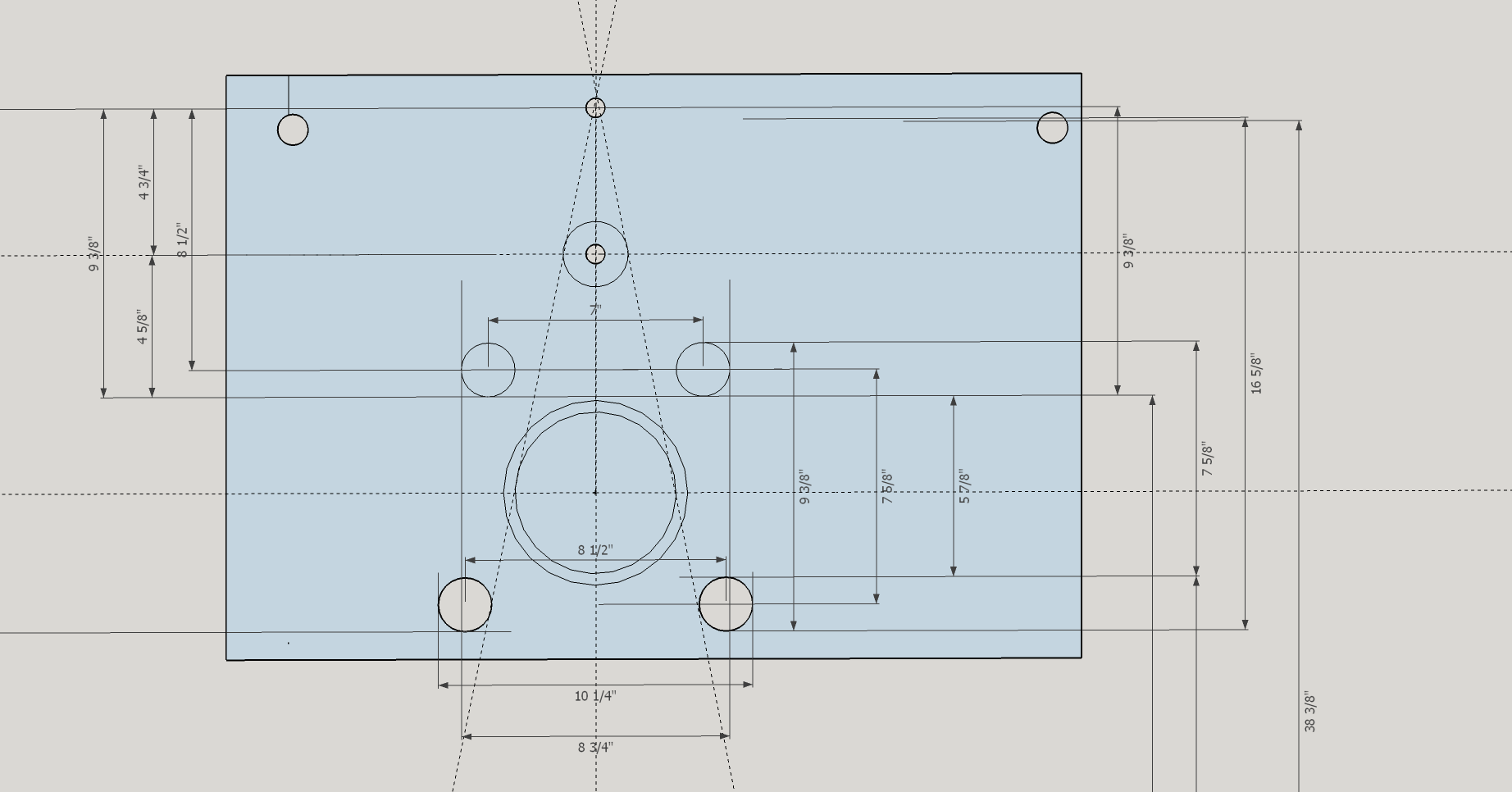

That being the case, I'd like to hear about what you see if you rehang that plumb bob. What are the dimensions from the string to the tubes. Whatever the distance is should be the same. That is, the plumb bob should hang straight down the center line.
Shaft and Tube Relationship with Plumb Bob.png (37.61 KiB) Viewed 14541 times
