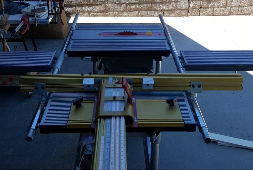

Showing with extension tables
- SS TL-LS - 2.JPG (85.25 KiB) Viewed 5771 times

Somewhat related, I saw on the FB group a while back where someone didn't want to pay Shopsmith for the price of the replacement stainless steel tape measure for their 520, so they added on some angle aluminum to the 520 rails to give a flat platform where they could mount their own permanent tape measure in place of the magnetic one. I can't dedicate my 520 to saw mode only like in the picture below, but this idea does look interesting.
