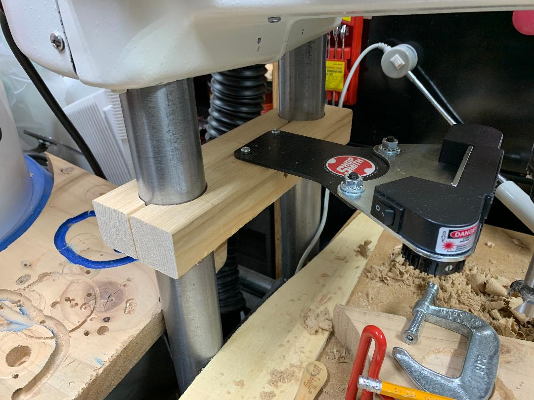

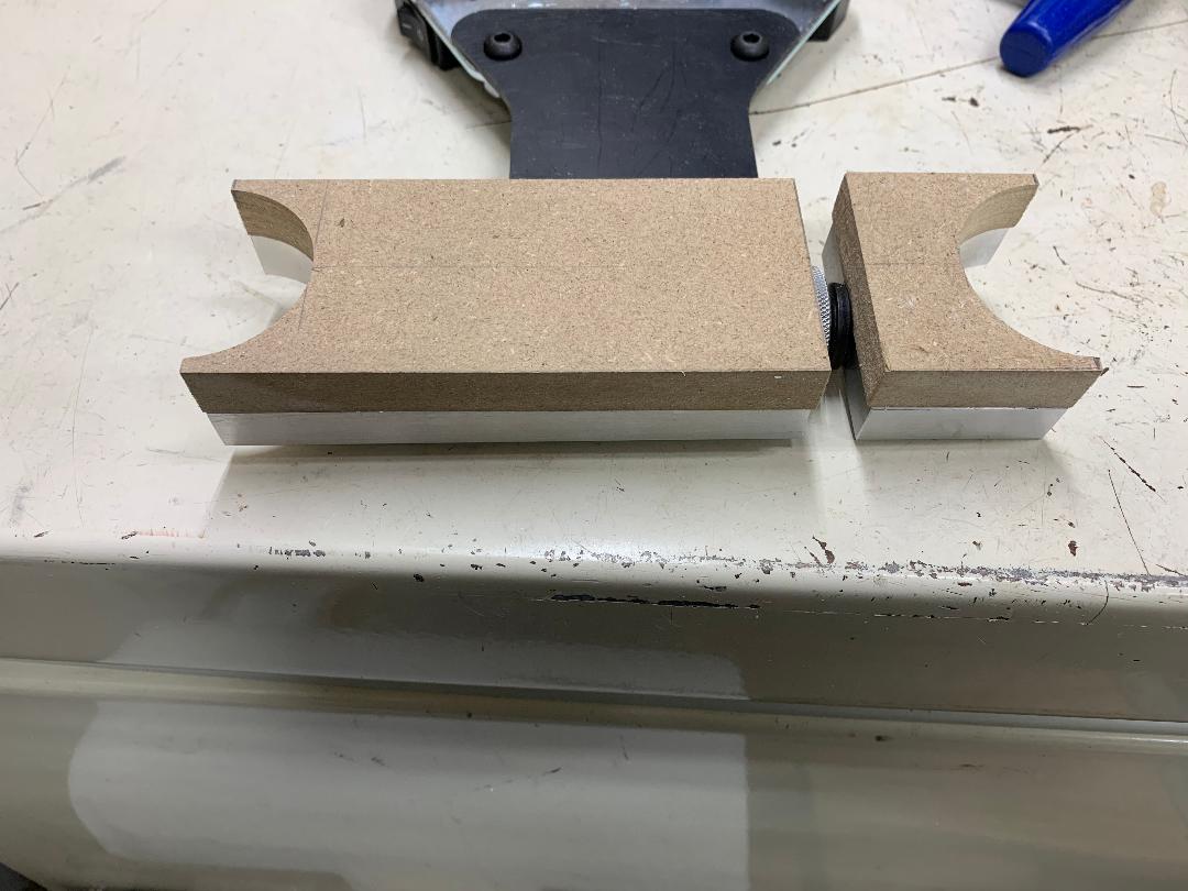

I tried 3 tests, first I made a twin bracket to the one that mounts to the tubes so it effectively made it wider hoping that would stabilize it. That did not work.

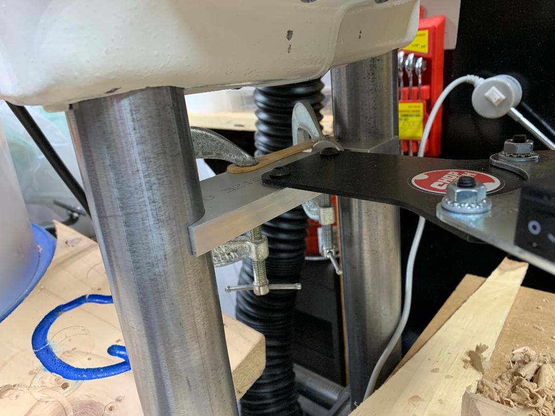

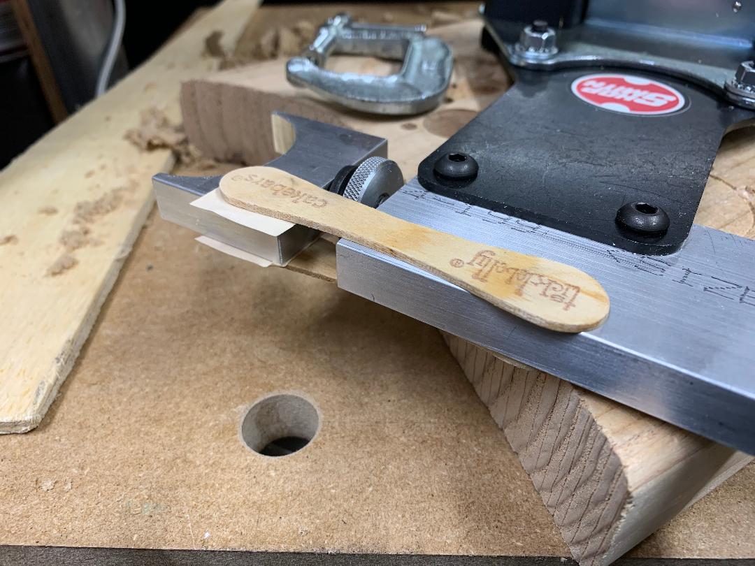

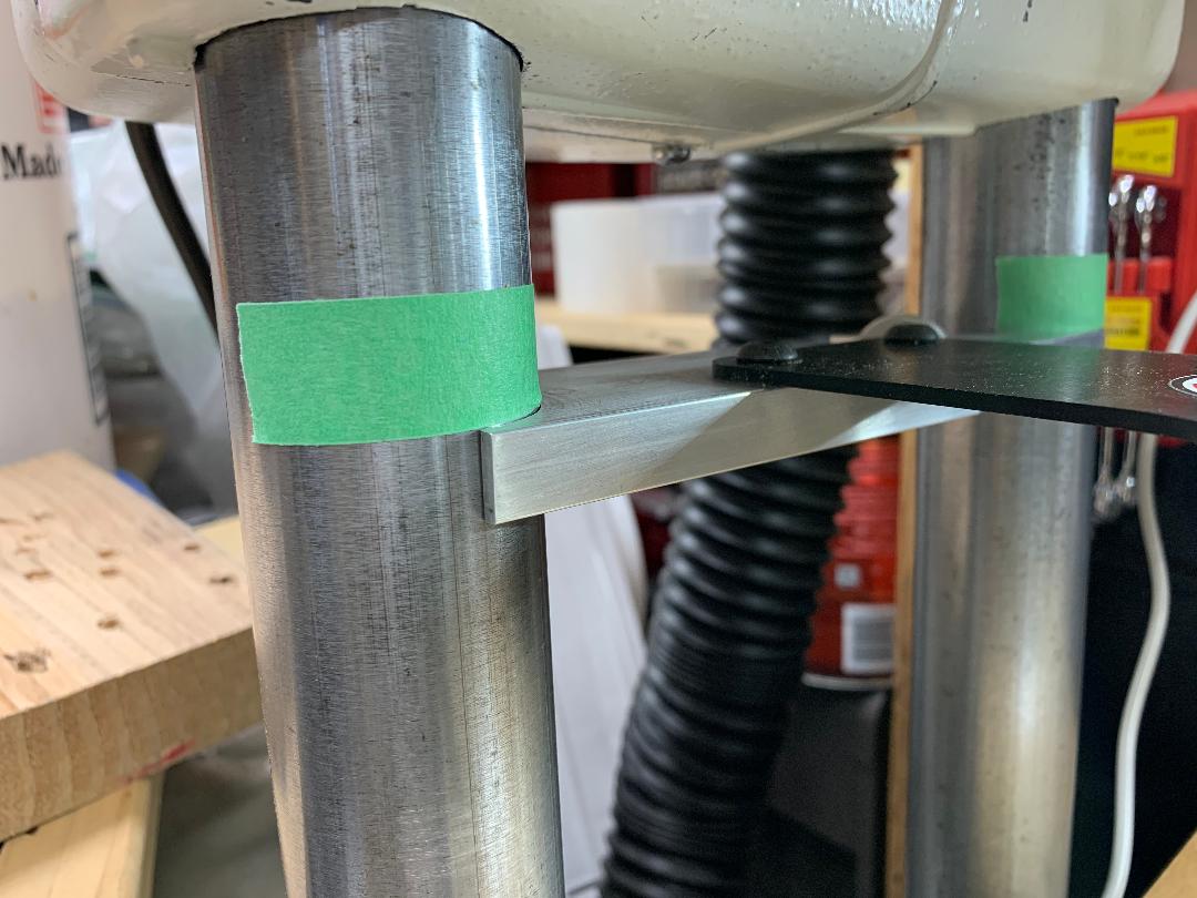

Next I tried to make the part more stable by make it more like a single part. That didn't work either. Here is the idea, the tape is just to hold it in place for the clamps.
try 2.jpg (130.53 KiB) Viewed 17024 times
try 2a.jpg (102.43 KiB) Viewed 17024 times

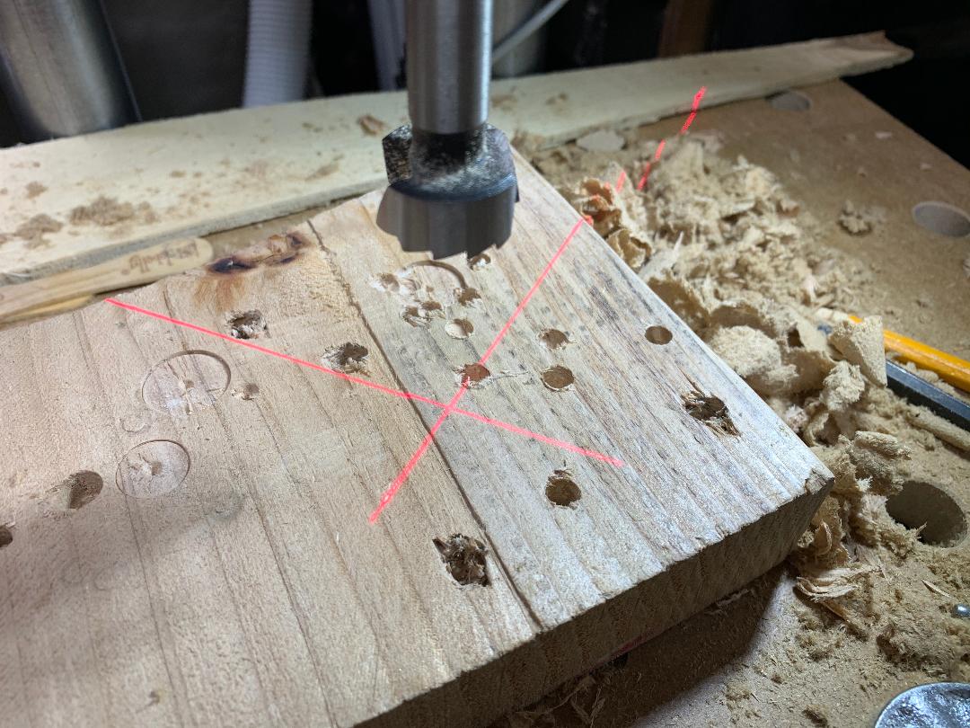

This worked but then I noticed something else, the laser lines do not extend forward like on the other laser. I have to look more at this. Not necessary a problem but I'll spend some time examining things and report back.
Maybe someone who has one up and working can let me know how far past the cross point the beams go?

The laser light seems about the same between the two units I have. I have a sewing machine light, LED type that I use for task lighting. Even with that on I can still see the beams. I took a picture of what I see, can't say how bright it has to get to make the lines go away but not going to happen in my shop. Outside it would be another story.
task light on too
task light on too
laser view.jpg (159.19 KiB) Viewed 16738 times

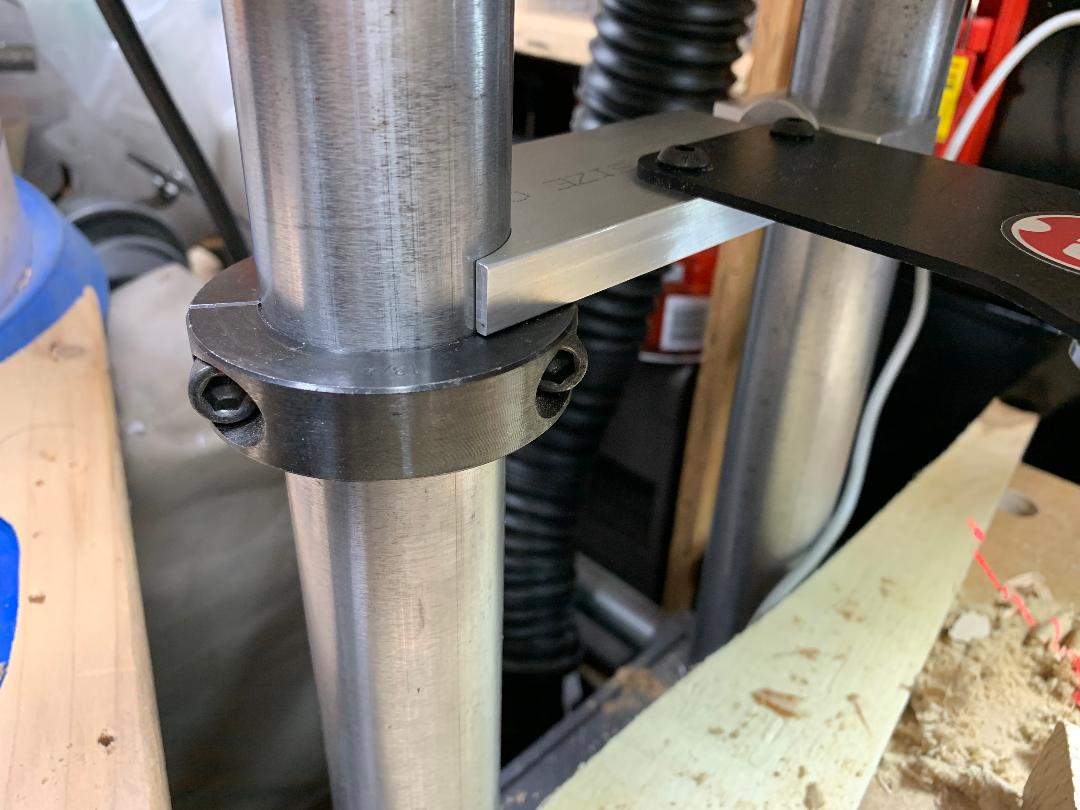

My latest testing has a usable solution for me. I have a 2 piece clamping collar that I installed below the bracket on the left side. This makes a world of difference!
laser mount.jpg (93.64 KiB) Viewed 16738 times
I think these are in the $12 to $15 range. These can be very useful for other things so just make sure it is the split type so it is easy on and off.
At least for now this appears to be a workable solution but might cost you an extra few bucks if you don't already own one.

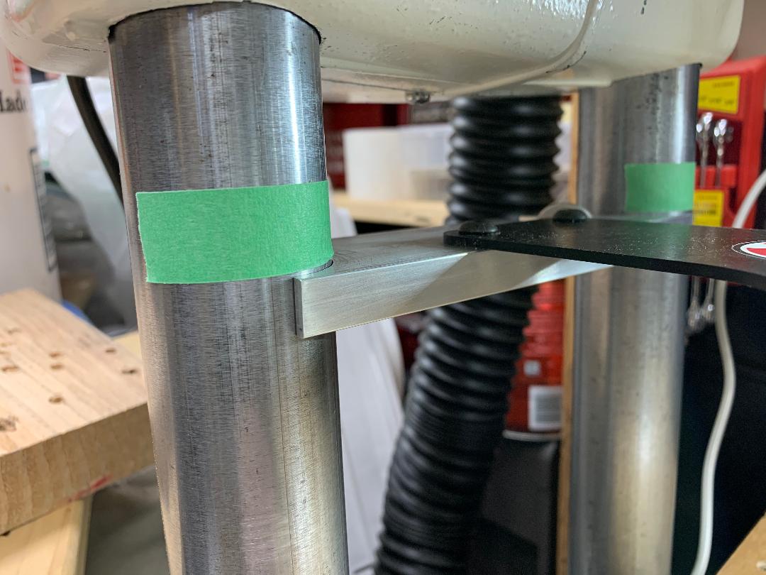

That movement then causes the bracket to slide down, here are a before and after shot:
While this doesn't effect the point of the lasers it will if the two ends don't move the same amount, I have not seen this so perhaps it can't happen. What it does do is worry me that normal vibrations of operation will cause the laser bracket to slowly lower itself or even become loose enough to slide down.
The result of that movement in the lasers:

In your after.jpg picture it looks like the arc of the bracket does not quite match the diameter of the way tube. Maybe it is just an optical illusion.
