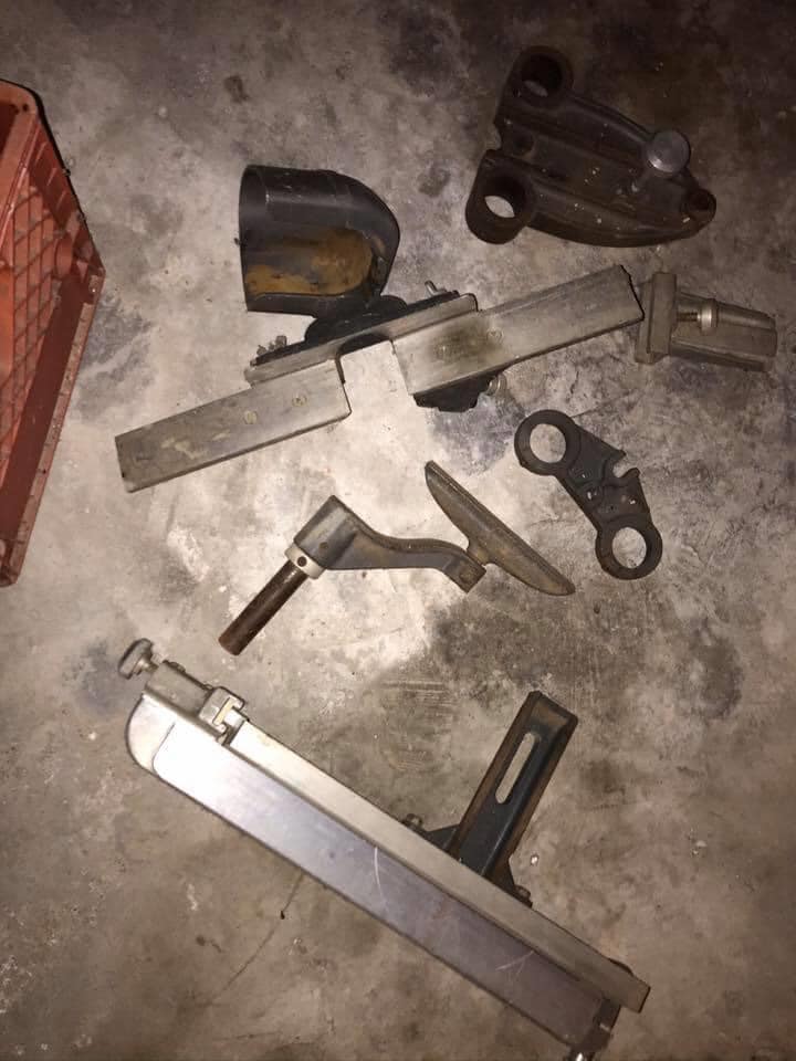

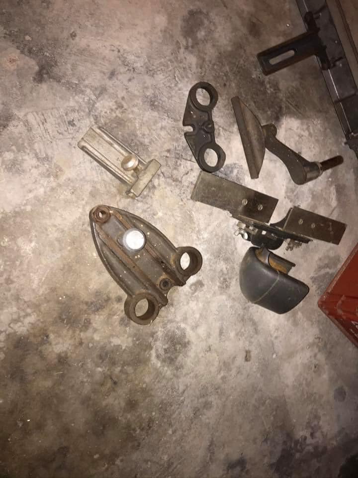

Hi Russ
This unit just came up for sale on the FB group
Thought you might be interested in the pics as it was made in the eastern plant.

Thanks for the post Ron. It has version 4 of the Headstock which includes the Quill Depth Indicator and the keyed double wedge Quill Lock. It has the version 1 Base, Headrest and Belt Cover. The Extension Table is the Metal version with the rear locking Fence. It is these versions of the parts on the Model 10's when they changed from the 10E to the 10ER. For the Eastern Plant the lowest S/N I have for a 10ER (ER on the Logo/Serial Number Plate) is ER18361 and for the Western Plant it is S/N R31007. There does not seem to be any specific change made to the Model 10's at the time they changed from the 10E to the 10ER. Maybe it is when they were running out of 10E Logo/Serial Number Plates and had to make more they decided there had been enough changes to warrant calling it Revised.
