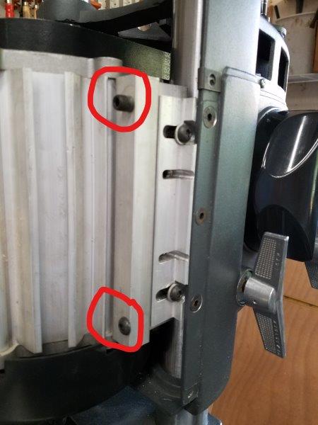

tensioning screws.jpg (36.95 KiB) Viewed 1792 times
In Jim's video he says after turning them out 2 turns, he only turned it back in one turn and it was plenty tight. Also I don't understand how turning one screw in and the other one out keeps them aligned.
Anyway - now getting excited I could be back in business today with all everyone's help.
Standing by for further guidance.
hal
Re: Noisey Power Pro Headstock
Posted: Sat Oct 10, 2020 12:36 pm
by edma194
Those screws just used for the alignment position. The two screws on the side of the mount have to be loosened. Tightening one of the alignment screws pushes the motor away from the mounting block attached to the casting, loosening just provides room for the motor to move outward. If gravity doesn't move the motor when you loosen an alignment screw then you have to push it in place yourself. Once in position you lock the position down by tightening the other two screws on the side of the mount. Take your time doing the alignment, you need to get the lower belt parallel to the upper one, and both perpendicular to the spindle shaft.

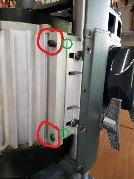

Can I ask which book you have? I can expand on detail for any of the steps. I'm using the DIY PP Upgrade Instructions combined with my recollections from the Jim McCann video. I would deviate from those though and use a 4 MM tool for this. ;)
Pre-conditions - Upper belt should be tight using the eccentric. To me, this means some deflection under moderate pressure but less than 1/8". All PP countersunk mounting screws installed (item 50) with the lower belt in place on both pulleys.
Slightly loosen the four Tension Locking button head screws. These will lock the motor in position after it is tensioned and aligned.
You will primarily be adjusting two things, but the adjustments interact somewhat. The two setscrews at the pulley end primarily adjust belt tension. The two button head screws at the other end primarily tilt the motor to align the face of the motor pulley to the pulley on the idler shaft. You want to adjust the screws in pairs, for example if you want to tighten the belt you'll adjust the two setscrews tighter equally by counting turns or fractions of turns. Thus, you need that equal starting point.
Two get your screws to an equal starting point, I would adjust the two tension setscrews to measure a gap of 1/8" at the pulley end of both mounts. (If this would make the belt too tight, decrease the gap size). Then adjust the two button head alignment screws to get the same gap at the fan end of the motor. Note that the screw pairs have the opposite effect, clockwise on the setscrews to increase the gap, but counterclockwise on the button heads to increase the gap. When both gaps are even on both ends and even with each other you have that equal starting point. I've edited your pic to show where you'll measure the gap, circled in green. This gap being even at both ends is a starting point only, it does not have to end up that way.
Gap in green
Gap in green
tensioning screws.jpg (68.85 KiB) Viewed 1775 times
From that point you should be able to follow the procedure in the manual. The manual uses a straightedge to properly align the motor pulley to the idler shaft pulley. The way I remember the video this wasn't done. In your case I recommend doing it with the straightedge per the manual.
After completing the motor belt tension and alignment you'll need to go back and perform the belt tension balance portion. Sequence is backwards in the manual. Note that the eccentric bushing is going to have a much different feel and is not going far in either direction once both belts are on it and properly tightened. This is normal.
- David

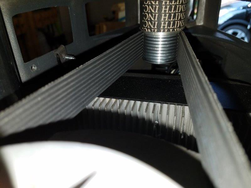

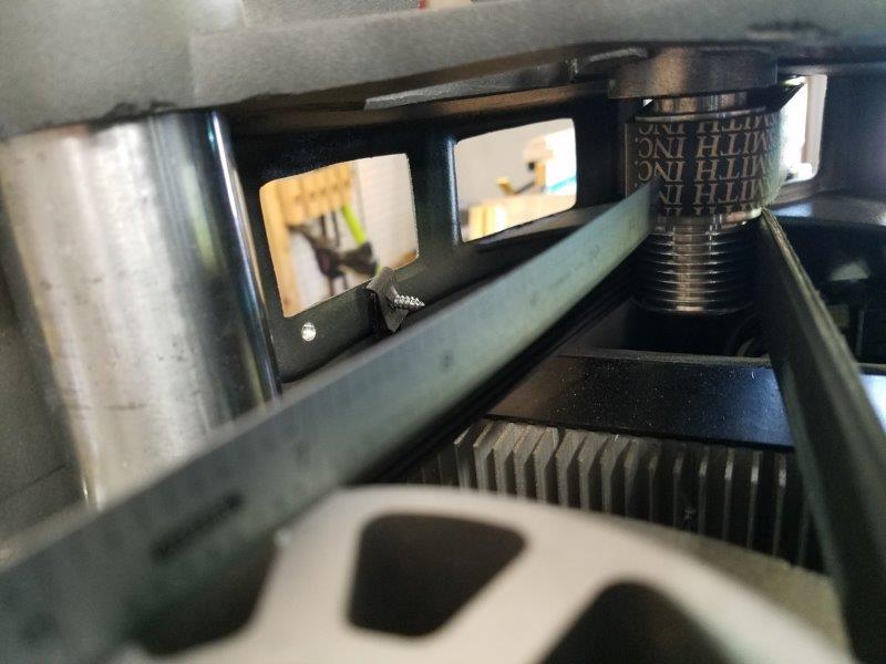

Edma - When you say "Take your time doing the alignment, you need to get the lower belt parallel to the upper one, and both perpendicular to the spindle shaft." I don't know how to check those things other than what I did with the straightedge. The little v ridges in the motor belt seems to ride in properly in the motor pulley and idler grooves. I can't see inside the upper belt to tell if that's seated properly. Also this all seemed to fit so I assumed I assumed belts were parallel to each other and perpendicular to the idler shaft.
Poly V belt on motor pulley and idler pulley

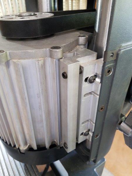

After following all the instructions I ended up with what I thought was a tight belt with little flex, I ended up with fairly even gap on the motor mount adjustment plates.
gap on motor mount plate
