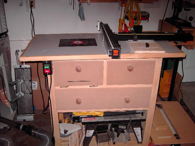

edmo51 wrote:I like the looks and funtionality of your RT. Is this your own design or did you modify some other? Would appreciate if you could post more info on the dimemsions/details.
Thanks in advance
Would you believe it started out as a chest of drawers? :D About half way through I decided I needed a router table instead. The dimensions of the base (chest of drawers) is/ 16 1/2"d X 35 1/2"w X 40"h. The top is two sheets of 3/4" MDF glued together with Formica top and bottom and trimmed with 3/4" pine. I really didn't have any plans. I just winged it and that is what came out.
Here is a more recent picture with the Jointech fence mounted.
George
Ft. Worth, TX.
Go TCU Froggies

Do you use the Jointech fence for accuracy or joint making,e.g. dovetails,etc..
Ed Mo

edmo51 wrote:Thanks George for the info.
Both. What I really like about it is the "repeatable" accuracy.
George
