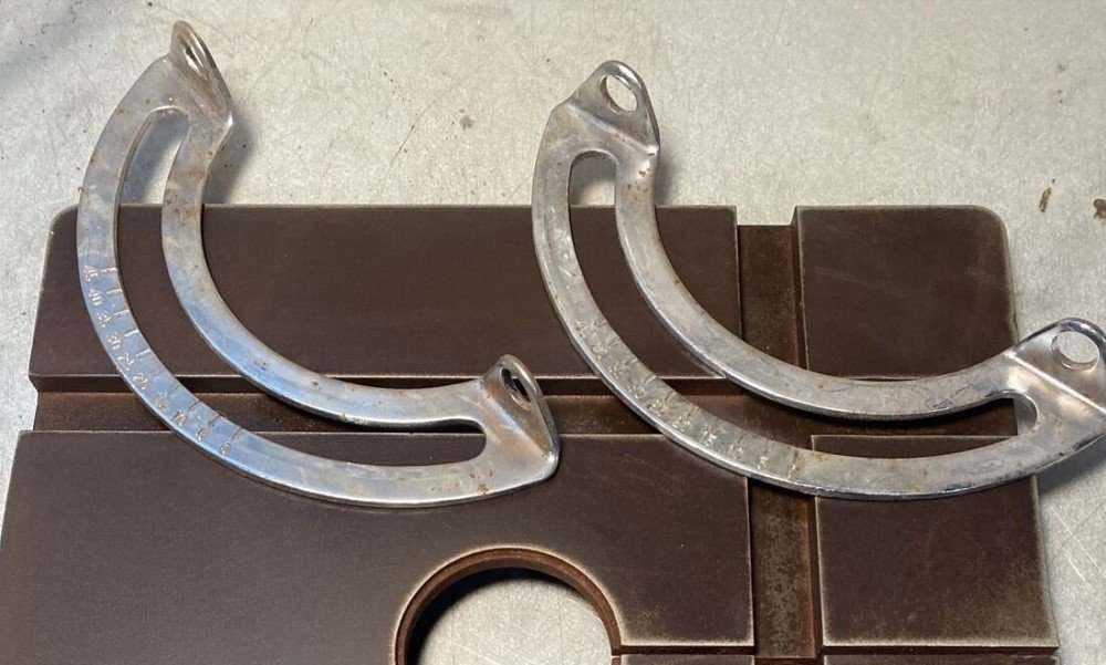

chapmanruss wrote: Tue Mar 09, 2021 2:27 pm There are variations in the Trunnions or at least how they mount between the newer Bandsaws and the older ones. I am not sure about the Trunnions themselves but the parts used to mount them to the Bandsaw's Main Frame (back) is different. This is where one of the changes in the Main Frame assembly occurred. The earlier Bandsaws have pressed in sleeves with "V"s in the ends which has been changed to slip in sleeves with smooth ends for newer/current Main Frames. Other hardware there has changed to match. I'll try to check the actual trunnions between the 1956 and the 1998 Bandsaws when I remove the tables to check for shim washers discussed before. If the Trunnions are different at all they must be very close or at least have the same mounting spacing to allow upgrading to the aluminum table from the cast iron table without including new trunnions. I am not sure when the Main Frame assembly changed but a Bandsaw made in December 1985 had the pressed in sleeved and a February 1996 has the slip in sleeves. This is a close as I can come for this change based on Bandsaws I have seen/owned.
I doubt that you can tell much from this but it is the most telling of the trunnion pictures taken when I had the table off.

I went through the 1956 and 1998 Bandsaws today. First the trunnions are almost the same. The only difference between them besides the 1956 trunnions not having the black coating is the tabs where they bolt to the table have around 45° cut off corners (see picture below) whereas the newer ones look like the ones in Dusty's picture above.
_
picture from another source
Bandsaw Cast Iron Table Trunnions.jpg (119.48 KiB) Viewed 9114 times
_

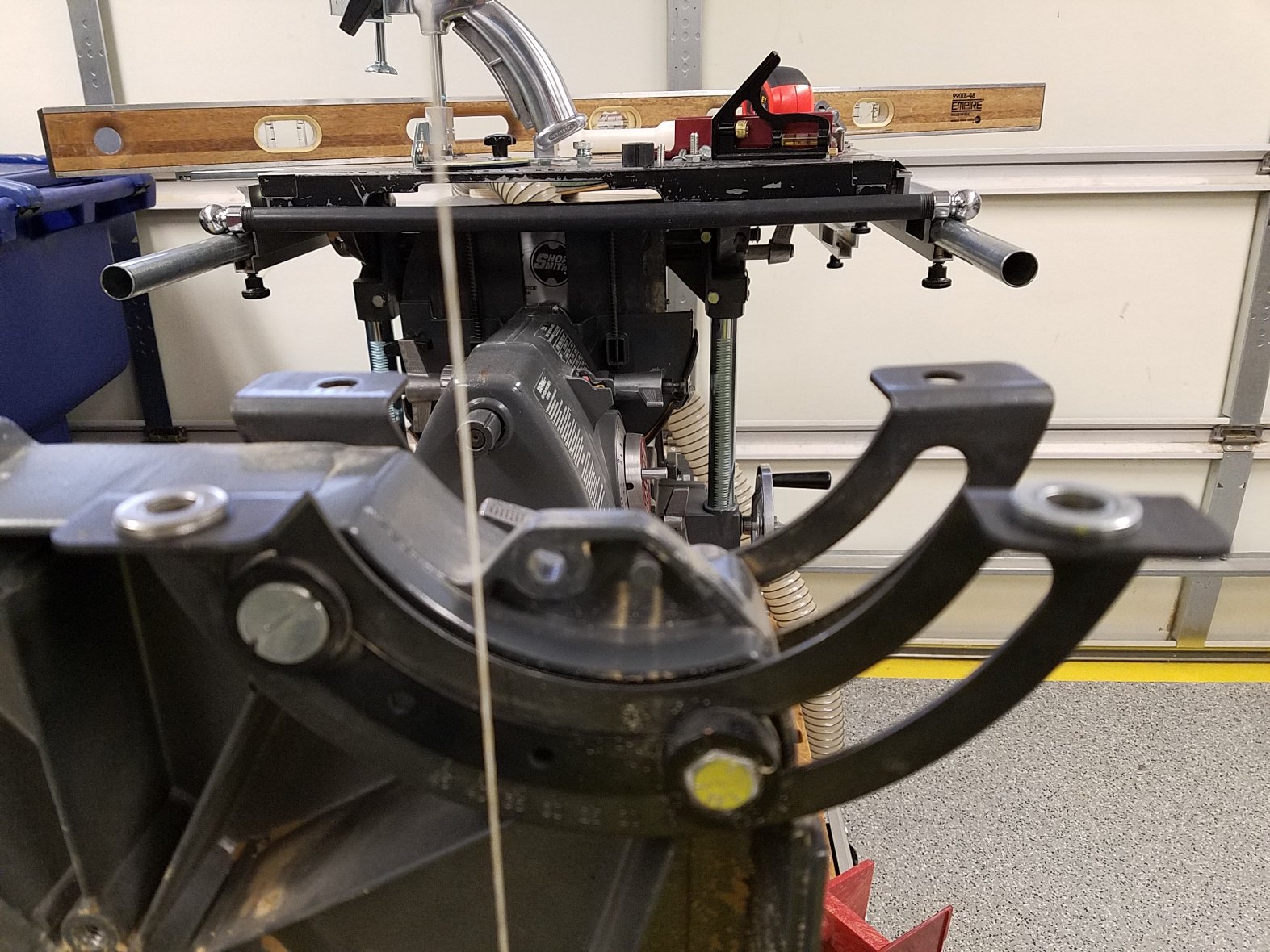

I finished some upgrade work to my bandsaw, tension gauge window, hole for the tension wrench, dust collector port, and Carter guides. I finished up by removing and cleaning the table and trunnions. It's never been shimmed and was always perpendicular to the blade, or very nearly so. I don't know how that was the case without shims. In finishing it up I got the blade absolutely perpendicular to the table with the addition of just one soda can shim on each side of the front trunnion ends. Perhaps the previous owner adjusted the backup bearings somehow, the upper wheel seems to have the slight angle. This saw is serial number 135408, don't know how old that is.

dusty wrote: Tue Mar 09, 2021 3:38 pm
Referring to that picture, those look like common washers. Were they shims supplied with the bandsaw? If I put something as thick as those on the front trunnion the blade would be angled far forward at the top. Next blade change I'll have to get in with a straight edge and check the alignment of the backup bearings to each other and see if I can compare that to the wheels. I'm also finding the explanation of the tilt to be off some how.

edma194 wrote: Thu Mar 25, 2021 10:12 am
JPG, I'm not clear what you are describing about the lower wheel bevel. Is it the shape of the tire track that is beveled to have the blade drift toward the backup bearing?
What you see in that photo are common washers and I used common washers (not those) when I did the table installation. I used a combination of common washers and shims for the final table installation. Yes, the table tilt without the washers was quite significant. I DO NOT believe that my table and trunnions should be used as a reference to what ir correct. I believe mine to be atypical.
