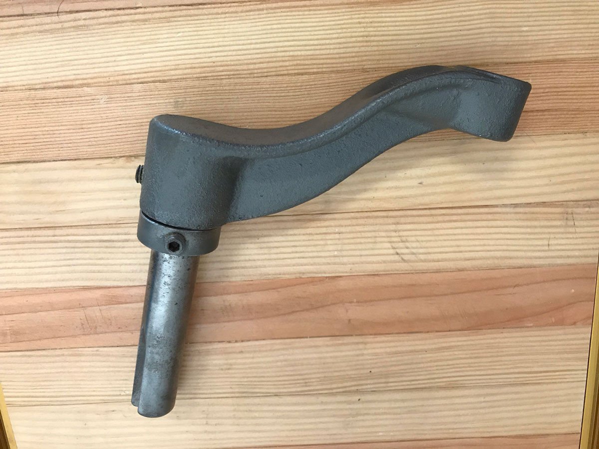

I wasn't sure about the diameter or length of the rod in the picture with the knobs. Below is the Arm, Post and Collar without the 8" tool rest. It is the later version of the arm so a little different than yours.
_ _
Anyway you still need to have two 13" long table posts. There isn't really anything special about the table posts so you could buy a piece of rod stock to make a replacement. Something to note it does not even have to be solid rod since late in production the Model 10ER had hollow posts. Just make sure the post stock is rigid enough.
