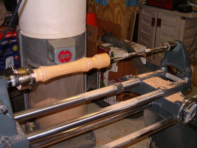

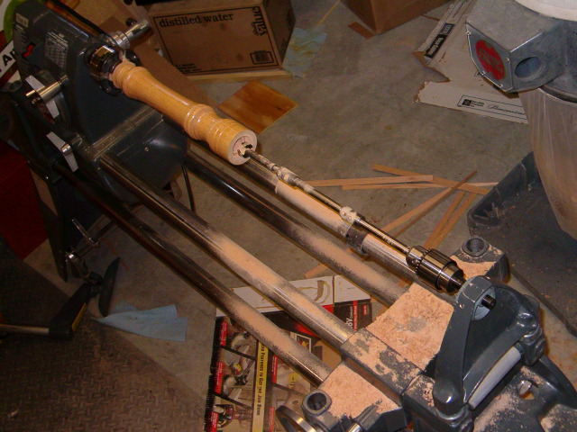

Here is an example of horizontal boring in the lathe mode. This was boring a 1 1/16th inch hole through a 15 inch long pepper mill base.
After finishing the boring, I messed with the tailstock. Previous posts are absolutely correct. The stop rings must be placed in the right place and the tightening bar must apply pressure to each post of the tailstock.
This boring probably would have gone easier, if I had a 1 1/16th in. spade bit. But in this case a forstner did the trick with two 6 inch extenders. needed frequent backing to relieve shavings/dust.

Now scale that down(stock and bit) and keep the tailstock 'slop' constant. You can appreciate the frustration pen borers are experiencing.:(
My point was - there is no - or should be no tailstock slop!
If I can bore through 15 inches and come out in the center on the other end, I should be able to bore a straight hole through 5 or 6 inches with a relatively shorter drill bit shank.
Maybe the problem is the ability or inability to chuck up a piece that measures only 1/2" X 1/2" and align it to the tail point. Or maybe it is a problem in aligning the center of the quill with the center of the tail piece.
