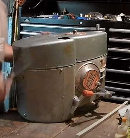

I see an early greenie splined quill shaft and a shaft spacer that is easily confused as a second bearing. So I conclude it has a Gilmer drive.
The "extra" screws are a "feature" of the "A" headstocks.
If that is indeed a second bearing, thee has a modified quill.

JPG wrote: Wed Jun 29, 2022 8:14 pm I see an early greenie splined quill shaft and a shaft spacer that is easily confused as a second bearing. So I conclude it has a Gilmer drive.
Dang it JPG!
So that guy on the internet that says "If there is a second bearing, you will know if there is something located about 4 inches in" might be wrong?
Well Bun of a Stitch.... I got a narrow flash light in there and the entire bushing turns with the shaft in the Quill, While it has grease, it also has some slop. Looks like I may need a new one.

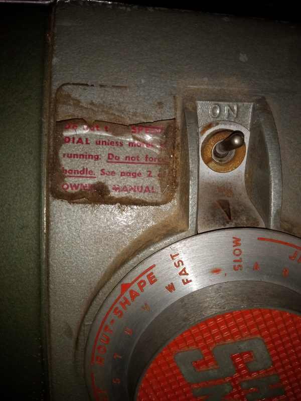

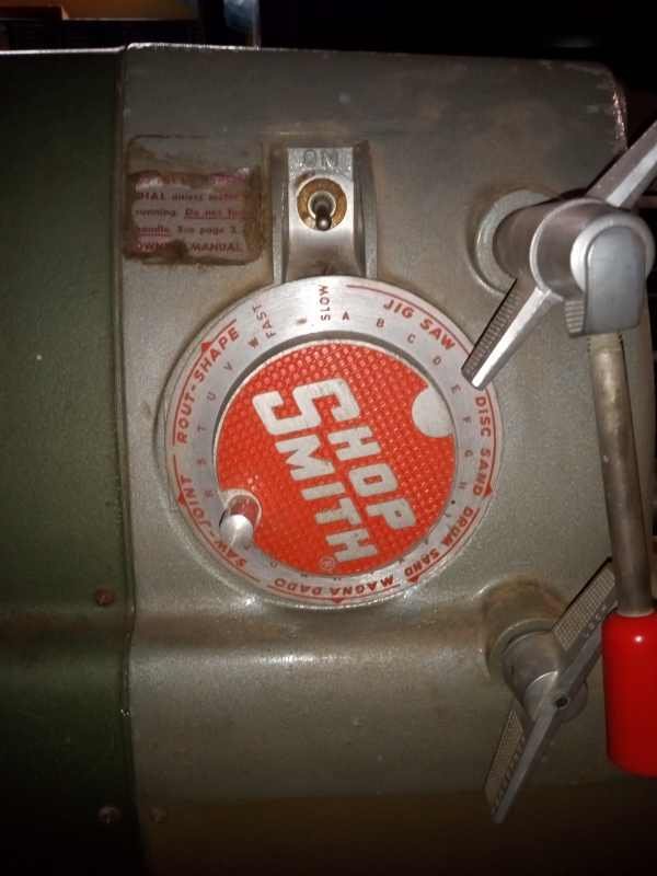

Not sure pickup will work. SS AIUI does not do that sort of thing anymore.
You definitely have an"A" headstock and yer pix above are indeed of the speed above saw-jointer interlock.
With it running, when you attempt to increase the speed above saw-joint it should hit that stop. You must depress the metal strap with the arrow in to allow adjustment above that point. This assumes a period accurate indicator ring that is different on the back side from the current ring.

JPG wrote: Thu Jun 30, 2022 9:57 pm Not sure pickup will work. SS AIUI does not do that sort of thing anymore.
You are correct, they replied to email stating they don't work weekend nor do they have a retail store any longer. :(
I will check that out, I have not run it all the way up as of yet.

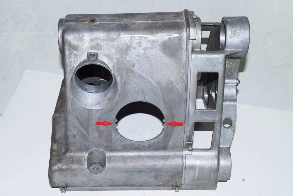

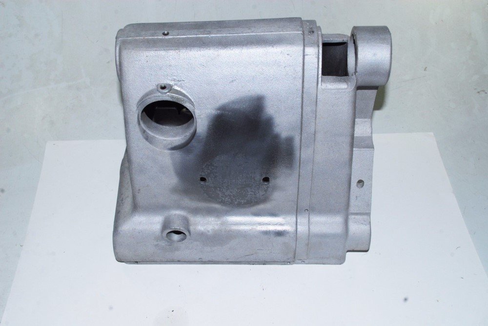

Adding the access hole to the back of the "A" Headstock can be done. I haven't done it myself, but I have seen information on doing it. The hole cutout was made by marking the circle on the Headstock casting. It would be the same diameter as the spacing between the holes for the attachment posts on the "A" Headstock Name Plate. The important thing to end up with are the ears on either side of those original holes and completing the circle top and bottom past the ears. Drilling holes around the inside of the circle marked in the casting and finishing with filing the circle smooth is one way I saw someone had done it. The first picture below is an "A" Headstock casting showing the two holes for the Name Plate. The second picture is of a "B" Headstock casting with arrows indicating the ears that keep the Name Plate straight. The "A" Name Plate and "B" Name Plate are the same with the addition of the clip to keep the "B" Name Plate in place. If you do this change you will need to get a "B" Name Plate. The Name Plate Shopsmith currently sells as replacement parts here on this website is for the "C" Headstock and is different in its attachment than the "B" Name Plate. You will have to find a "B" Name Plate on the used market.

chapmanruss wrote: Fri Jul 01, 2022 12:20 pm Adding the access hole to the back of the "A" Headstock can be done. I haven't done it myself, but I have seen information on doing it. The hole cutout was made by marking the circle on the Headstock casting. It would be the same diameter as the spacing between the holes for the attachment posts on the "A" Headstock Name Plate. The important thing to end up with are the ears on either side of those original holes and completing the circle top and bottom past the ears. Drilling holes around the inside of the circle marked in the casting and finishing with filing the circle smooth is one way I saw someone had done it. The first picture below is an "A" Headstock casting showing the two holes for the Name Plate. The second picture is of a "B" Headstock casting with arrows indicating the ears that keep the Name Plate straight. The "A" Name Plate and "B" Name Plate are the same with the addition of the clip to keep the "B" Name Plate in place. If you do this change you will need to get a "B" Name Plate. The Name Plate Shopsmith currently sells as replacement parts here on this website is for the "C" Headstock and is different in its attachment than the "B" Name Plate. You will have to find a "B" Name Plate on the used market.
You have expressed an interest in upgrading from the Gilmer Drive to the Poly V drive if it hasn't been done by a previous owner. I am not sure if you have determined that yet. There is an option to buy the needed parts on the used market. This is something I don't often recommend but Mark V owners upgrading to the Power Pro Headstock doing the Do-It-Yourself option are left with extra parts which are the Poly V parts you need and often they sell them on online auctions. Most are in good condition being removed from running Mark V Headstocks. Many have double bearing Quills. There can be savings going this route but a word of caution it is still a buyer beware market so ask questions as to the condition of the parts.
Thanks for those photos, it makes complete sense what needs to be done from what you outlined here. Cast (pot metal) requires care, 60 year old cast, even more I think sometimes. :D

I ran it up to fast, and now that I looked below the switch, I can see how that would work to block Fast. Key item is "would" cause it doesn't work. Between the flex of the plate you push and the some what looseness of the indicator dial, it seems to slow down but turn past anyway. Something to look at during overhaul.
The dial is stubborn, I am going to clean and oil those sheaves to get it to play nicer next.
