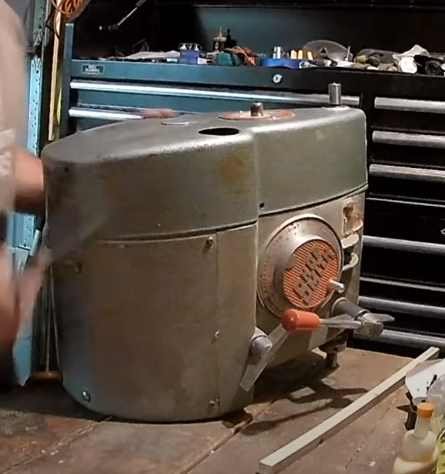

I see an early greenie splined quill shaft and a shaft spacer that is easily confused as a second bearing. So I conclude it has a Gilmer drive.
The "extra" screws are a "feature" of the "A" headstocks.
If that is indeed a second bearing, thee has a modified quill.

JPG wrote: Wed Jun 29, 2022 8:14 pm I see an early greenie splined quill shaft and a shaft spacer that is easily confused as a second bearing. So I conclude it has a Gilmer drive.
Dang it JPG!
So that guy on the internet that says "If there is a second bearing, you will know if there is something located about 4 inches in" might be wrong?
Well Bun of a Stitch.... I got a narrow flash light in there and the entire bushing turns with the shaft in the Quill, While it has grease, it also has some slop. Looks like I may need a new one.
You have mentioned an A + B head stock before.
This one on a video looks just like mine colors included, but it lacks screws... Likely the B?

I mentioned it in one of my earlier posts here. There is a lot of the history and the changes made to the Mark 5/V in my thread Shopsmith Mark 5 What When and Where from here in the Community section. When the Mark 5 was introduced in March of 1954 it had the "A" Headstock which started with 8 screws to hold on the Belt Cover. That changed to 6 screws in 1955. Later in October of 1955 it changed to the "B" Headstock still using 6 screws to hold on the Belt Cover. In 1957 the Belt Cover was changed again to be held on by only the 2 screws we still see today. The "A" Headstock included a high speed lock under the speed dial held on by the power switch. This speed lock was discontinued with the change to the "B" Headstock. That speed lock is one of the easiest ways to tell an "A" Headstock from an early "B" Headstock.
The Mark 5 Greenies were painted in a combination of Hammered Finish Green and Silver paints. The reason the paint on the Headstock casting itself doesn't match the Motor Pan is the difference in materials they are made of and time. That is unless someone has painted it differently at some point.
Some of those videos you can find online can be a great help but can also be misleading as JPG points out for the single bearing Quill of the Gilmer Drive Mark 5's. That quick check "trick" from the video doesn't take into account the bushing (as you call it) inside your Quill. In the first Mark 5 Owner's Manual it is part number A3061 called a Spindle Washer. It is on the Spindle and should not contact the inside of the Quill sleeve. Judging by your description there is really no need to change the Spindle Washer on your Quill. It wasn't until September of 1984 that Shopsmith began supplying two bearing Quills for the Mark V. Poly V drive Mark 5/V's can be changed to the two bearing Quill without additional changes being necessary. There have been some who made two bearing Quills by machining single bearing Quills adding a second bearing back inside the Quill body.

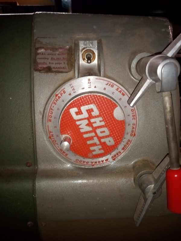

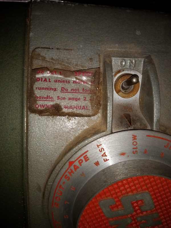

You definitely have an"A" headstock and yer pix above are indeed of the speed above saw-jointer interlock.
With it running, when you attempt to increase the speed above saw-joint it should hit that stop. You must depress the metal strap with the arrow in to allow adjustment above that point. This assumes a period accurate indicator ring that is different on the back side from the current ring.

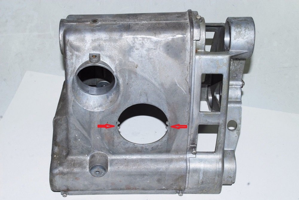

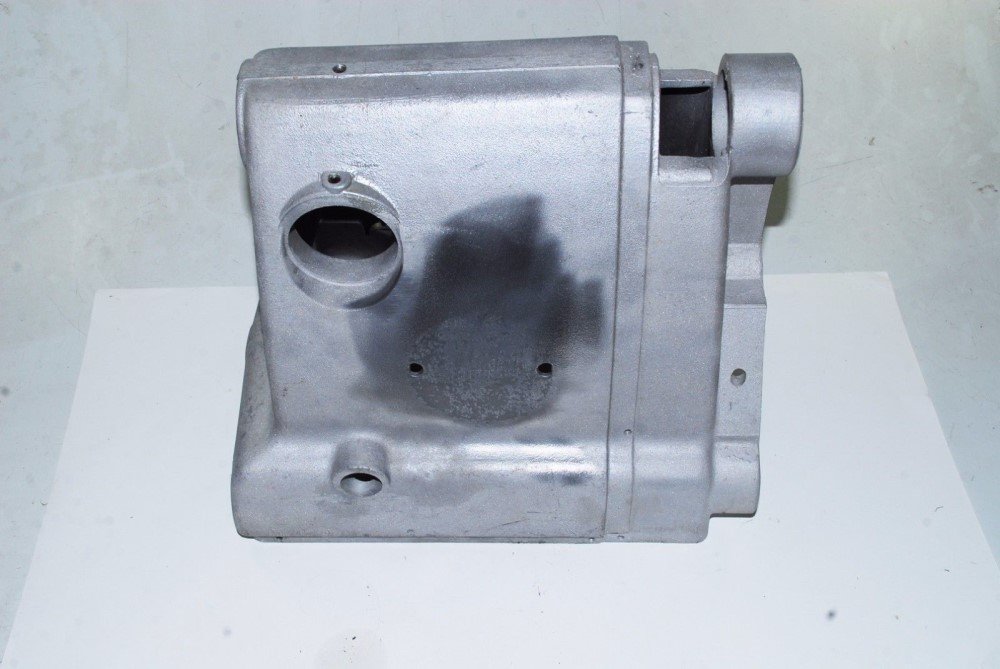

Adding the access hole to the back of the "A" Headstock can be done. I haven't done it myself, but I have seen information on doing it. The hole cutout was made by marking the circle on the Headstock casting. It would be the same diameter as the spacing between the holes for the attachment posts on the "A" Headstock Name Plate. The important thing to end up with are the ears on either side of those original holes and completing the circle top and bottom past the ears. Drilling holes around the inside of the circle marked in the casting and finishing with filing the circle smooth is one way I saw someone had done it. The first picture below is an "A" Headstock casting showing the two holes for the Name Plate. The second picture is of a "B" Headstock casting with arrows indicating the ears that keep the Name Plate straight. The "A" Name Plate and "B" Name Plate are the same with the addition of the clip to keep the "B" Name Plate in place. If you do this change you will need to get a "B" Name Plate. The Name Plate Shopsmith currently sells as replacement parts here on this website is for the "C" Headstock and is different in its attachment than the "B" Name Plate. You will have to find a "B" Name Plate on the used market.

chapmanruss wrote: Fri Jul 01, 2022 12:20 pm Adding the access hole to the back of the "A" Headstock can be done. I haven't done it myself, but I have seen information on doing it. The hole cutout was made by marking the circle on the Headstock casting. It would be the same diameter as the spacing between the holes for the attachment posts on the "A" Headstock Name Plate. The important thing to end up with are the ears on either side of those original holes and completing the circle top and bottom past the ears. Drilling holes around the inside of the circle marked in the casting and finishing with filing the circle smooth is one way I saw someone had done it. The first picture below is an "A" Headstock casting showing the two holes for the Name Plate. The second picture is of a "B" Headstock casting with arrows indicating the ears that keep the Name Plate straight. The "A" Name Plate and "B" Name Plate are the same with the addition of the clip to keep the "B" Name Plate in place. If you do this change you will need to get a "B" Name Plate. The Name Plate Shopsmith currently sells as replacement parts here on this website is for the "C" Headstock and is different in its attachment than the "B" Name Plate. You will have to find a "B" Name Plate on the used market.
You have expressed an interest in upgrading from the Gilmer Drive to the Poly V drive if it hasn't been done by a previous owner. I am not sure if you have determined that yet. There is an option to buy the needed parts on the used market. This is something I don't often recommend but Mark V owners upgrading to the Power Pro Headstock doing the Do-It-Yourself option are left with extra parts which are the Poly V parts you need and often they sell them on online auctions. Most are in good condition being removed from running Mark V Headstocks. Many have double bearing Quills. There can be savings going this route but a word of caution it is still a buyer beware market so ask questions as to the condition of the parts.
Thanks for those photos, it makes complete sense what needs to be done from what you outlined here. Cast (pot metal) requires care, 60 year old cast, even more I think sometimes. :D
I considered staying with the existing emblem, cutting to hole as large as the emblem would hide and leaving the holes for the emblem on like a tab. I have seem many automotive emblems that have inserts that can be put in the hole that allow the emblems to come on an off with a little wiggle and then apply a rubber casket to the back of the emblem to keep it from raddling... It may be a totally bad idea. 8)
If I had a diamond hole saw for Ceramic tile that size, I wonder if that would cut it.

I ran it up to fast, and now that I looked below the switch, I can see how that would work to block Fast. Key item is "would" cause it doesn't work. Between the flex of the plate you push and the some what looseness of the indicator dial, it seems to slow down but turn past anyway. Something to look at during overhaul.
The dial is stubborn, I am going to clean and oil those sheaves to get it to play nicer next.
