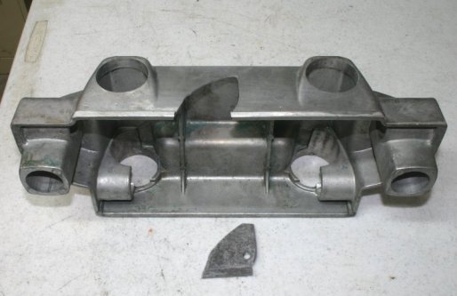

Repairing broken piece of casting
Here's the before and after pics of the carriage casting repair that I had to do. I came out pretty good and was reletively easy to do.
[ATTACH]3685[/ATTACH] [ATTACH]3686[/ATTACH]
I included more detail in a separate thread that I posted. I did the separate post to make the search easier.
