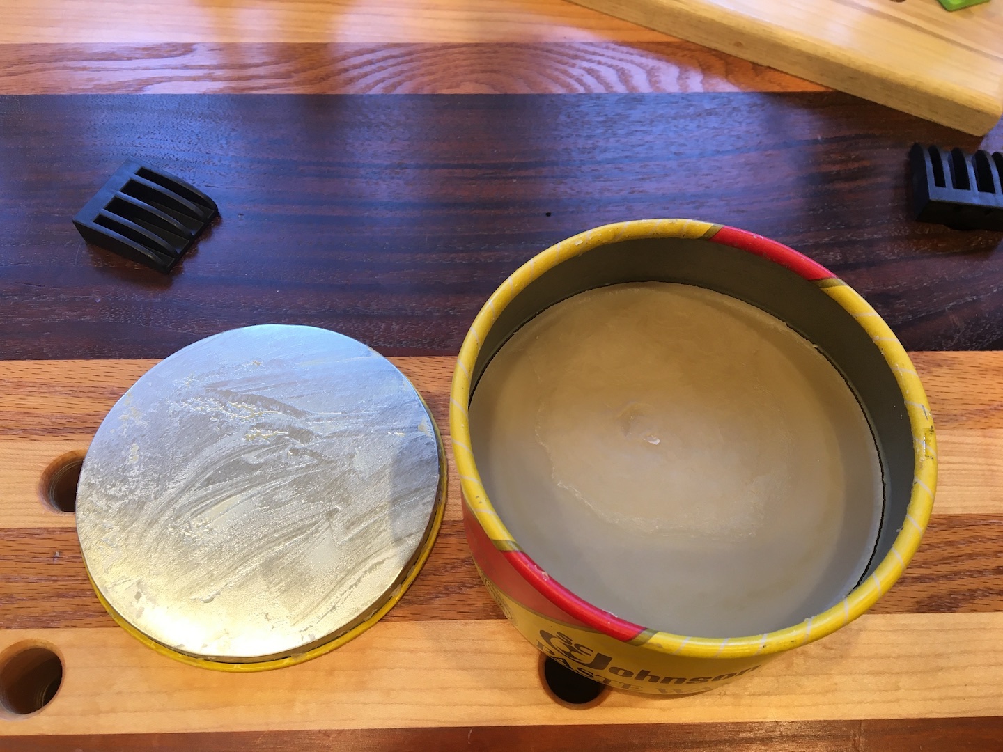

I had the very same experience: ordered through the mail, the can leaked in the box, the consistency of the product was like oat meal. I assumed the odd texture was because it partially melted during shipping. In particular, there were some whiteish lumps that I thought might be the paraffin element of the wax. I re-heated the can, mixed it thoroughly when it was all melted and then let it cool. The result is a uniform wax that is more solid than the lumpy stuff I started with. More importantly, it's more like the JPW that I have used for so many years.

- JPW after re-heating, mixing and cooling
- 2022 1031 JPW after re-heating and mixing.jpeg (465.53 KiB) Viewed 38789 times

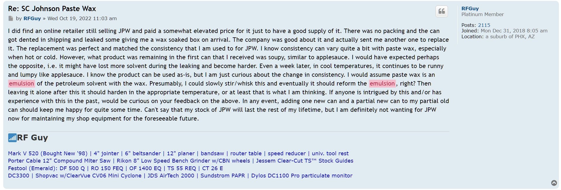

As I stated previously (below), I believe this is an emulsion because you have two different density materials (solvent and wax) suspended. I am tempted to try another method to reintegrate it to avoid the long open time and smell related. In cooking, emulsions are created all the time by vigorously whisking. However, any application of shear should work...an agitator like one used for paint mixing comes to mind. Not sure Home Depot is going to let me walk in and use their paint can shaking equipment though!
Heating is an alternative way to apply shear. I guess I could also use a paint stirrer in a cordless drill, but I would have to put the mixture in a gallon paint can and take steps to contain it so it doesn't splatter out of it. Not sure this is any better than the heating method though to be honest. Oh well, just random musings on how to do it while I procrastinate opening that can to smell it.

The melting process took about 6-7 minutes. Since it was all ready in a metal can, I simply put it on the the smallest burner at the lowest setting (if you are nervous about this approach you could use a double boiler with water -- I wax skis a lot during the winter and so am comfortable melting wax). Most of it melted in a couple of minutes and all of it was dissolved by about minute 5. There was virtually no smell because I deliberately kept the temperature low so that the wax didn't smoke. I did, however, do it when my wife was out running errands
