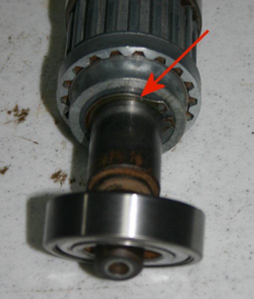

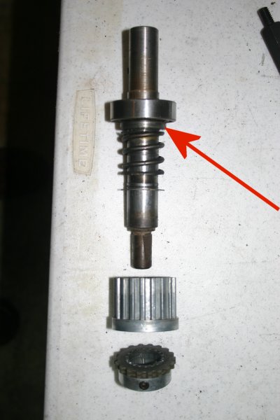

1. The bearing locations are either up against a shoulder OR up against a snap ring.edward wrote:Yes, I have the exact same one. Already replaced power cord. Pulled the wires before anyway said something. Hasty. Hasty.
So I'm suspecting that I'm up a creek with the locations for these new bearings...is that so?
Pics tonight... I hope.
2. The bearing tool you bought will be used to "pull' the bearings up against the stops.
3. Remember what I said in post #34.
Up against a shoulder
[ATTACH]3486[/ATTACH]
Up against a snap ring
[ATTACH]3487[/ATTACH]
- Img_5024mod.jpg (36.48 KiB) Viewed 2908 times
- Img_5022mod1.jpg (35.17 KiB) Viewed 2908 times
Sunny San Diego
Sunny San Diego

- Posts: 35434
Sorry Dusty! It ain't in any current exploded view! It is a 'Gilmer' version of the drive shaft(think top shaft in headstock). The skinny end is the shaft which sticks out the LEFT side of the headstock. Think SPT hub. The other end connects to the quill spline.dusty wrote:I'm having trouble identifying what you have pictured here. Could you cross reference the photos to the appropriate Exploded Views in the catalog. It would be greatly appreciated.
