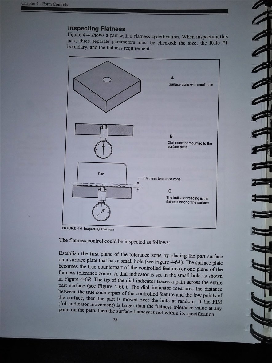

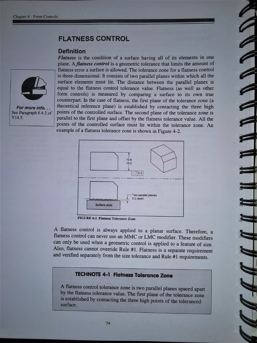

Some relevant pages from Krulikowski, Fundamentals of Geometric Dimensioning & Tolerancing. Explains how flatness is defined and inspected.
My table is also out-of-flat by a small amount. I have considered tapping the table to attach some steel plate or angle underneath the table.
- 20230106_092539 (2).jpg (187.1 KiB) Viewed 1196 times
- 20230106_092622 (2).jpg (151.41 KiB) Viewed 1196 times
