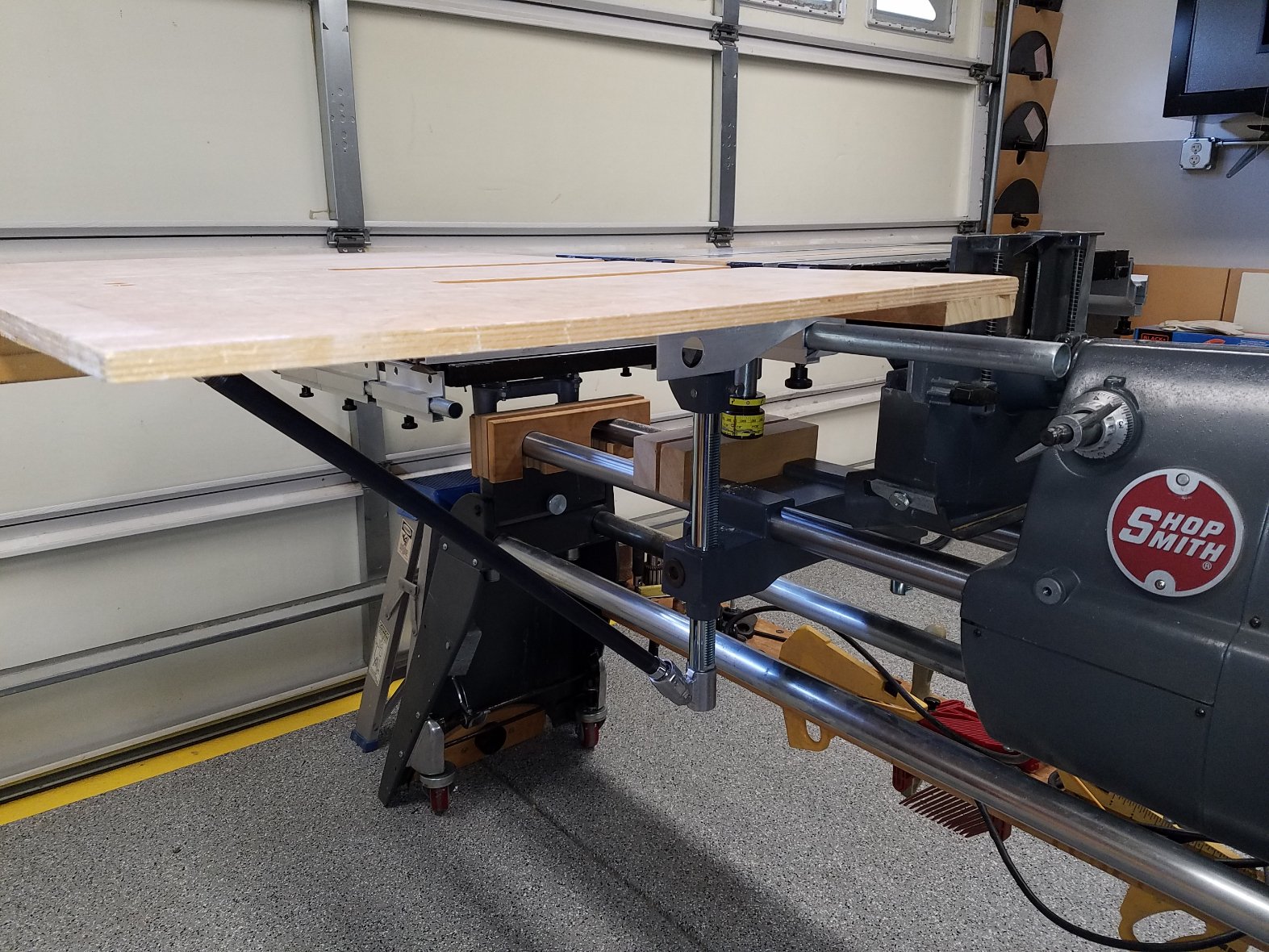

In the YT video Scott made brief mention of the Shopsmith outfeed table and something about a version that tilted and moved up and down with the Main Table.
I have one of those but it did not come from Shopsmith. I have been using a version of this table for years.
OFT and $60 Parts 008.jpg (398.9 KiB) Viewed 27493 times

dusty wrote: Sat Jan 21, 2023 9:05 am In the YT video Scott made brief mention of the Shopsmith outfeed table and something about a version that tilted and moved up and down with the Main Table.
To my surprise, the Mothership version is no longer available for any model. (https://www.shopsmith.com/ownersite/cat ... ttable.htm See note highlighted in yellow.)

I am not surprised. It did not
look impressive at all but then I am biased.
I had both a sliding cross cut and an outfield table. Both have taken up residence at my daughter's place. Need to replicate.
