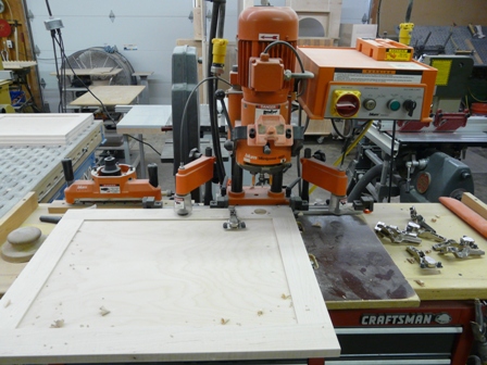

Inserting the Blum hinges.

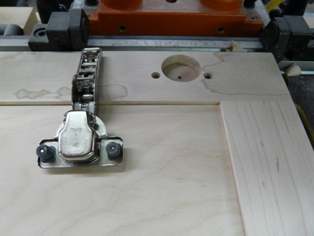

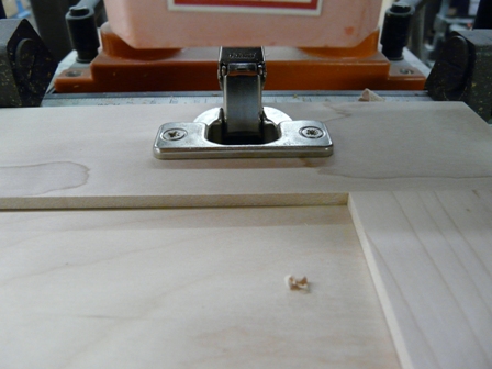

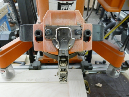

Before we install the molding around the panels we need to insert the hinges.This mini press is over 20 years old and still going strong. KKKKKnocking on wood. First pass it drills the 3 holes for the hinges. Then you place the hinge in the insertion ram and it presses it into the holes.

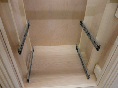

Roll out shelves

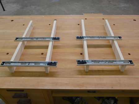

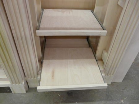

Before we hang the doors there are a couple of roll out shelves that need to be installed. They have to be built out 1 3/4" beyond the face frames to clear the hinges. This is my system.

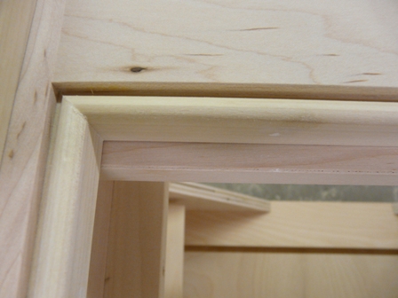

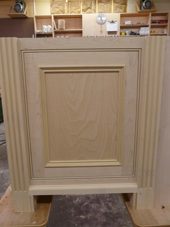

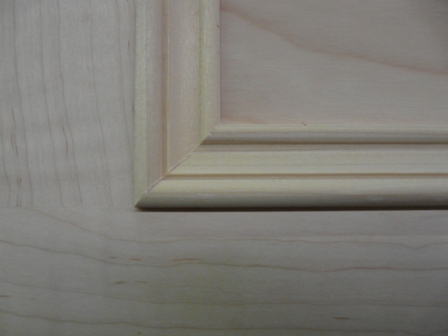

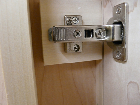

Hanging the doors

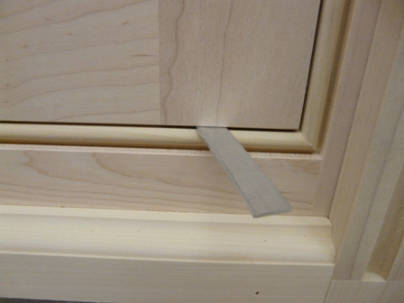

The procedure for adding the molding around the panel is basically the same as running the English bead. I think I mentioned before that the doors are sized to allow 1/16th inch all the way around. I start with a shim of that size and set the door on it. I then reach over or through the back and screw the hinge plates in place. A helper would be nice for this job. In this second picture you can see that I have added a door stop at the top. I also set the bottom of the cabinet up 3/8 of an inch. This gives us a door stop on the bottom as well.
