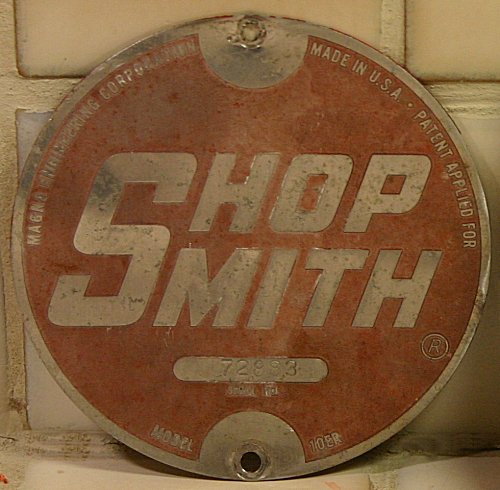

If you've been following the thread, you know that I decided to try and recreate the ER's nameplate from scratch using a chemical etching process. I made my first attempt last night. I'll post all the details as I fine tune the process but wanted to show you what it looks like. The prototype I made was not like Norm's Yankee Workshop prototypes. I consider it to fall into the "successful failure" category. Even though it doesn't look very good, I am at least on the right track. I know what I did right and also what I did wrong.
Here my original and the one I etch prior to paint:
[ATTACH]4902[/ATTACH].......[ATTACH]4904[/ATTACH]
You can see that there are a lot of surface "issues" going on but I am still happy in the way it came out for the first attempt. It was like magic watching the process.
It took about 20 minutes in a 135* heated bath of ferric chloride to get to this depth, which is about .004" just like the original. I expected to see some action going in the bath as it etched but there was absolutely none. I was checking it about every 5 minutes with an eye loop to see what was going on.
Anyway, there you are. I'll be fine tuning tonight.
p.s. Hey Blane (aka BPR), still think I should have just used the old one on my resto?

Mike, great job for a first attempt. What is the material you're using to make the new nameplate out of?
