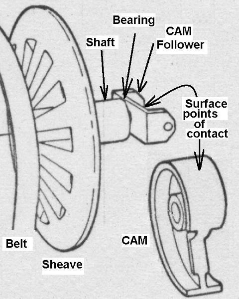

Mark VII - A very neat story
I've been researching the Mark VII for a long time. My father’s Mark VII was handed down to me a few years ago. The Speed Control CAM has always been the heart of my M7. Yes, the CAM was melted when I got it. I made temporary repairs, however they were never quite good enough for me. The major contributor to the CAM "melting" lies in the CAM follower (AKA the sheave control assembly). There is a press-fit bearing, a cam follower, and a one piece rod/sheave. The bearing is in direct contact with the CAM. When the bearing fails, it gets hot. While using the M7, the speed control is set to one position for a period of time. After the bearing has degraded enough; it will heat up; and the single point of contact between the cam follower and cam is where the damage will occur. I hope the attached picture helps. After considering the design and implementation, it occurred to me that the cam might have been designed to melt upon the failure of the press-fit bearing. The operator would know there was a problem without additional damage to the M7.
- Sheave-ControlAssyDetail00.JPG (48.85 KiB) Viewed 3583 times

[quote="ryansm7"]I've been researching the Mark VII for a long time. My father’s Mark VII was handed down to me a few years ago. The Speed Control CAM has always been the heart of my M7. Yes, the CAM was melted when I got it. I made temporary repairs, however they were never quite good enough for me. The major contributor to the CAM "melting" lies in the CAM follower (AKA the sheave control assembly). There is a press-fit bearing, a cam follower, and a one piece rod/sheave. The bearing is in direct contact with the CAM. When the bearing fails, it gets hot. While using the M7, the speed control is set to one position for a period of time. After the bearing has degraded enough]
Yes, the problem isn't really with the cam melting... It is not being able to order a new one and a spare...
I keep thinking I will take a cam off and take it to someone with a CNC mill and price having a few made but I just can't seem to get around to it. The replacements someone was once having made were cast aluminum rather than machined as I understand it.
As you indicate I suspect that if it did not melt when the bearing failed it might destroy the whole speed control or at least bend the speed control knob shaft.
I suppose that good maintenance in this case would involve regular replacement of the bearing whether it was failing or not. On a Mark VII or a Mark V even without the bearing failing the temperatures can raise pretty high inside of the headstock during hard long run use. I have long given thought to installing a blower at the rear inspection port blowing filtered fresh air into the headstock (with maybe something like a 3" muffin fan) which would exit out the bottom slots and around the left side shafts. It would use something like a small automotive pleated air filter to keep dust out. It would also pressurize the inside of the headstock slightly which would keep dust from migrating in through other openings. It should make all of the headstock components run considerably cooler. By blowing directly on that cam it might even be enough to prevent it from melting before the bearing started making noise and you knowing it was getting bad. It would be about a $10 fan and a $2 filter...
