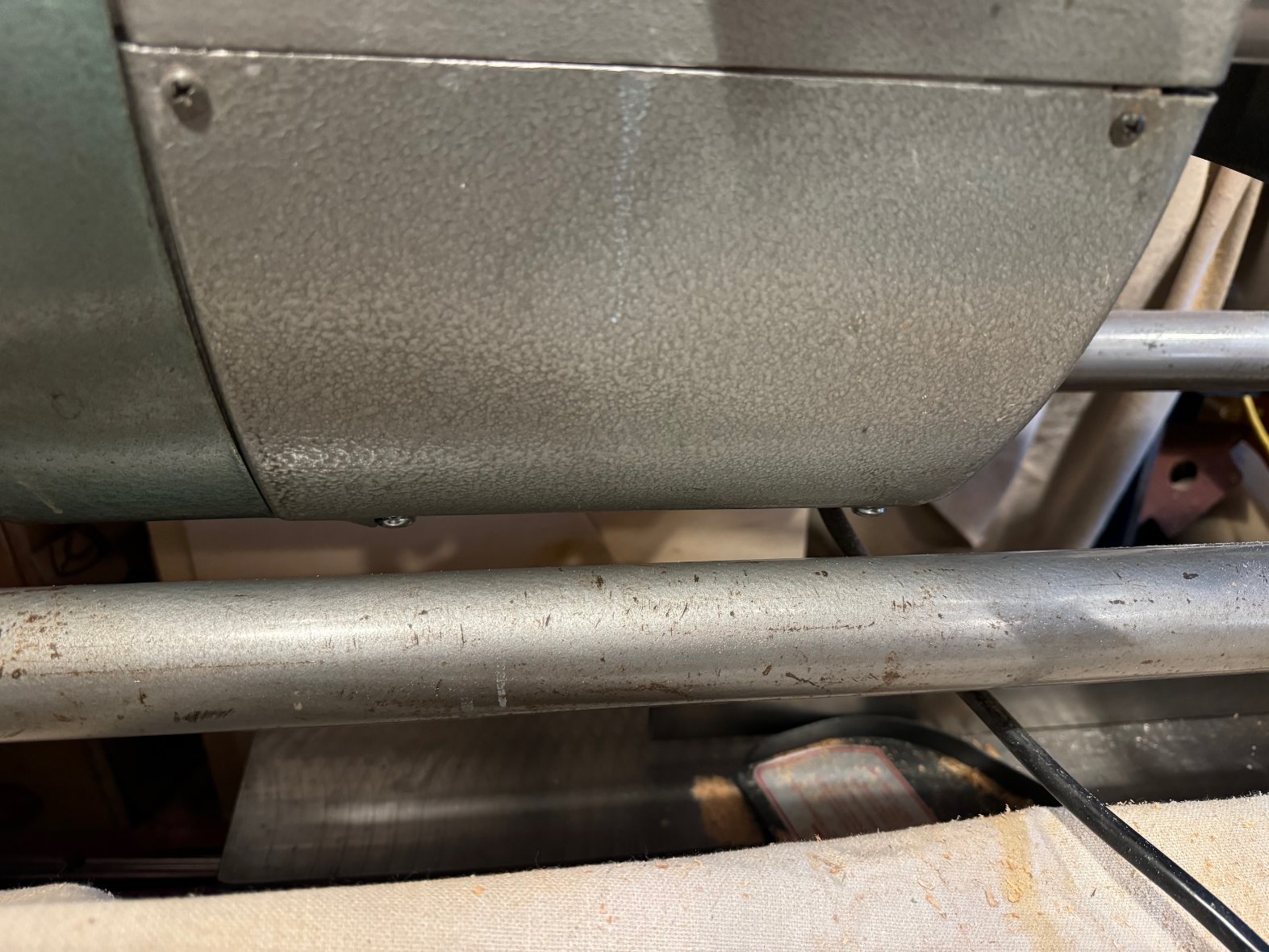

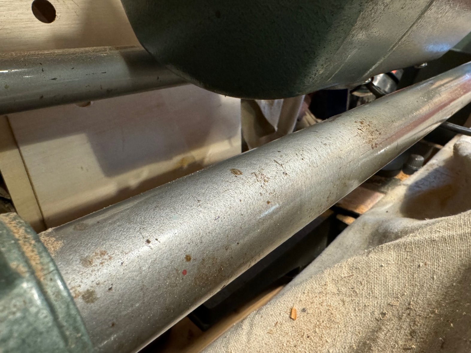

FWIW, here's the paint on my Greenie. It's quite shiny and smooth (no tactile texture, even though it has the appearance of hammer paint). It almost appears as if it's been clearcoated, though I would not expect they would be using clearcoat in 1960. The visual and especially the tactile texture is different from the motor pan, though the color is a pretty good match. AFAIK all the finishes on the machine are original but I certainly can't guarantee that.
Mark V 510 51-014654
Re: Yet another "Goldie" Restoration
YEP, that looks like my Goldie bench tubes. They may have been glossy >60 yrs ago.
