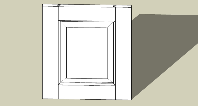

OK, this is my 4th attempt. Really having issues with the rail portion of this. 1st shot is with all layers showing.
[ATTACH]5354[/ATTACH]

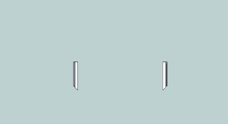

Next shot is with layer A turned off, so I should see just the rail. This is what I'm seeing.
[ATTACH]5355[/ATTACH]
Where did the faces go? If I only have layer A on, I don't see anything related to the rail on layer B.
I'm am totally frustrated and haven't got a clue as to what I might be doing wrong.

Pat, I think you failed to ungroup the stile that you copied to be a rail after making it and shortening it. If it disappears when you turn on Layer A only, click on the ASSY view to turn on all layers and then click on one of those surfaces, look at Entity Info window and see what layer those surfaces are assigned to. Watch the video, it should show all the detailed steps.

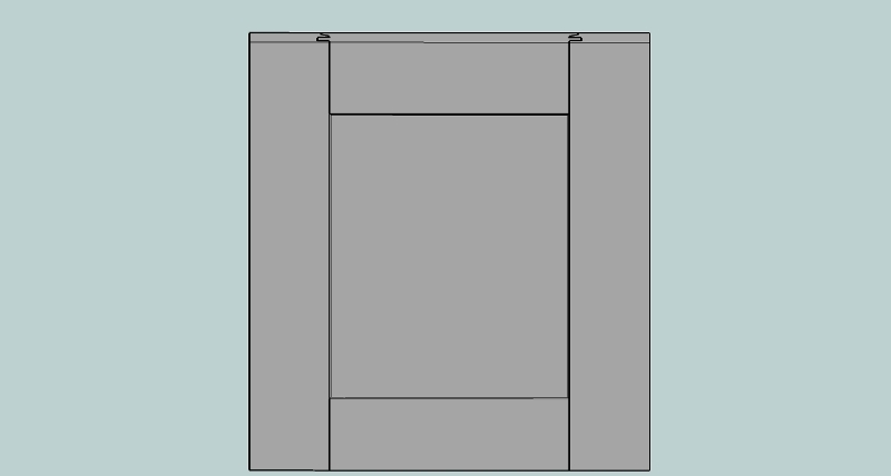

Lesson 5 completed.
[ATTACH]5371[/ATTACH]
I must admit that I can build a Raised Panel door faster than I can draw one at this point.
I will get better though. Come to thank of it, it took me a long time to build my first also.
[ATTACH]5372[/ATTACH]
This was a real learning lesson. Thanks to Tom for helping me out. I was having the same problem as shydragon. As in any new endeavor the more you do the better understanding you achieve. I will go back and run through this lesson a couple more times this week.

Tom gave me a work around for the problem. So all is good for now. I wonder if the operating system makes any difference? I'm running Vista Professional.
